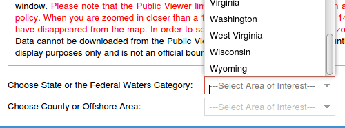

The dropdown goes up, then you need to slider up and down to get the "state or federal waters category, then do the same thing for the county. They (the programmers) could have done a better job with the user interface.
