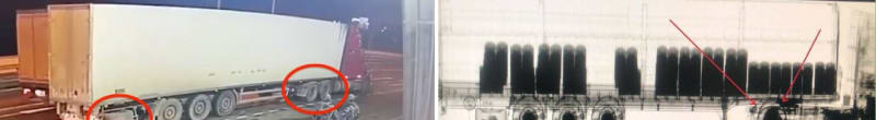

On the bridge event, Russian intelligence FSB has provided some very specific details about the individuals they believe responsible and the method
CNN said:
“The explosive device was concealed in rolls with polyethylene construction film on 22 pallets with a total weight of 22,770 kilograms,” the FSB report added, RIA Novosti also reported.
(2B)+(2B)' ?
Well and the suspected truck have one wheel axel to little. [ponder]

Did they just round up the usual suspects (ala Casablanca)? It seems their photo artists need to pay more attention to detail Link

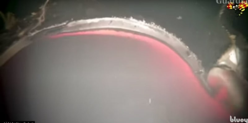

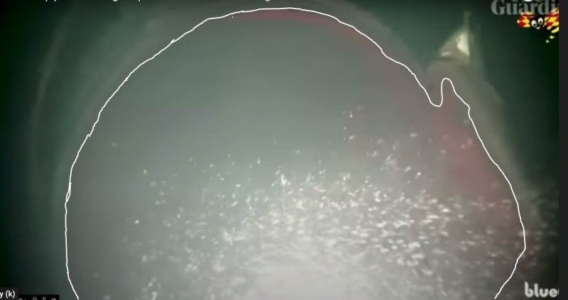

Some pictures of the pipeline. Obviously there isn't 50m missing as per the article, tension in the pipeline will have caused it to move after being severed.

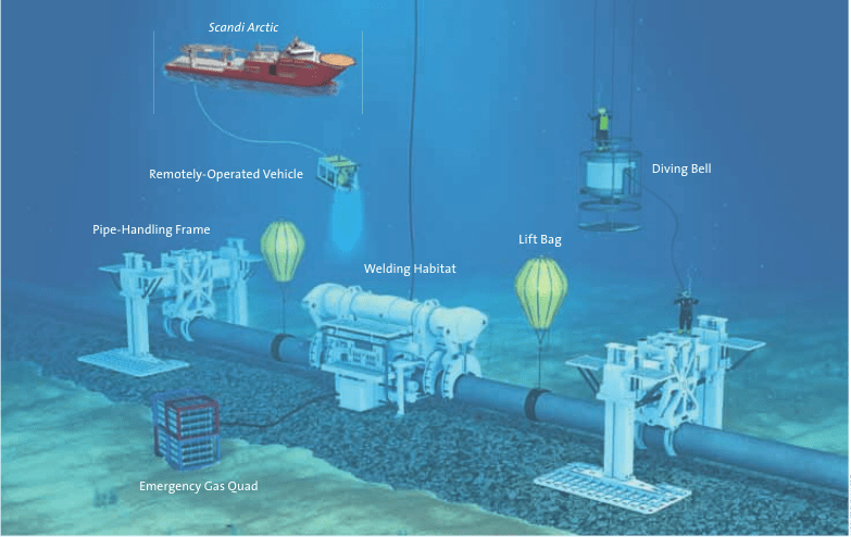

Regarding the repair - if politics allow - of the pipeline. It will be done in much the same manner as the different sections of the pipeline were connected originally.
The 1,200km pipe wasn't installed in a single operation, instead three sections were installed and then connected subsea (the three sections had different wall thicknesses to account for the reducing pressure along the length of the pipe.
Below is an illustration of the process.
Can't tell anything from those snippets and no idea where they've got 50m from. 5m of damage maybe... Tension might make it move a little, but not 50m.
Also they have no clue about pipeline design. The concrete is weight coating only with minimal reinforcement which is only there to hold the concrete together when they spray it and stop it falling off as they flex the pipe over the stinger and when it lays itself down on the seabed.. Does nothing in terms of pressure retention or "strength". the concrete does help it avoid damage from fishing etc, but that's not its primary purpose.
I would be very surprised if the pipeline wasn't built as a single string. Wall thickness varies due to any number of reasons, but agree they have a reducing pressure which they have used to their advantage. You just have a transition piece or transition pipe which is machined to give a smaller wt one end compared to the other.
What you show is a rather theoretical picture of a sectional pipeline repair, which is probably one of the ways they are looking at. You can also use mechanical high pressure connectors and bolting to avoid having to do welding subsea which is possible, but still really hard, especially when the pipe is full of water.....
The NS1 pipelines were built in three sections and this is how they were connected subsea. This info is all in the public domain.
The pipeline completely severed with 100 bar pressure. I would not be surprised if it whipped around like a fire hose which would explain such a large displacement.

Fair enough, they did indeed do it in three lengths due to the enormous length of the line, but it isn't common.
I am still trying tot work out how they weld a pipeline which is full of water, even if you have a pressurised welding habitat.
The bit they don't say is that each of the original sections had a laydown head attached which sealed the pipeline. You don't have such a think on the broken ends of the current pipeline, but you still need to insert a plug into each end to seal it off in the welding chamber. It is a bit vague on what happens to the welding plugs...
The attached has the same but in more detail if anyone is interested.
 https://files.engineering.com/getfile.aspx?folder=2bffd553-983f-4ec5-937a-1df66059ece6&file=underwater-tie-ins_19_20120327.pdf
Interestingly these pipes of 3 different wall thicknesses have a constant 1153mm ID.
The same picture appears in the documentation on Nordstream Pipeline's website.
A short pamphlet "Connecting the Pipelines".
They will most likely install stopples through a "hot tap fitting" on both sides of the repair. Do the weld, then withdraw the stopples.

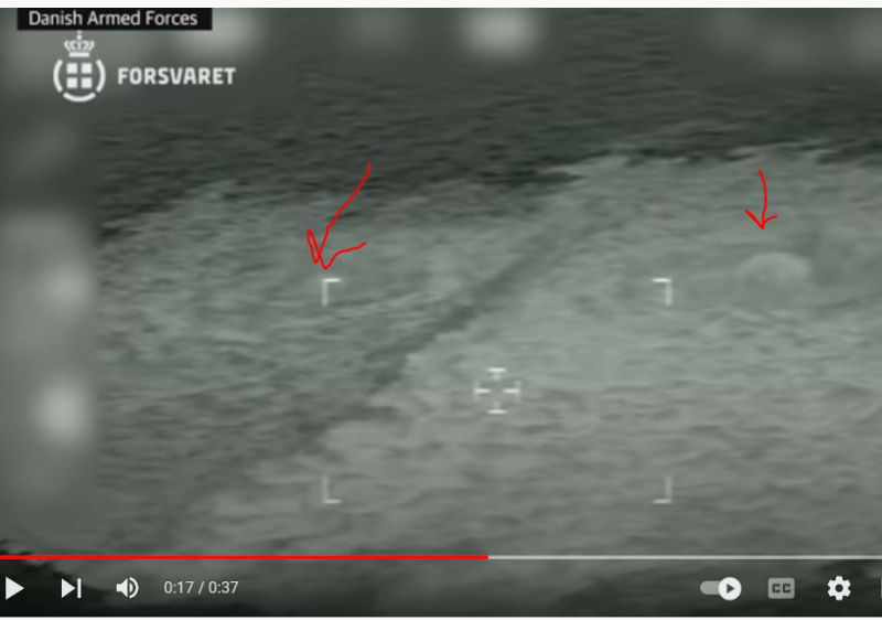

Are the seabottom scars from an anchor drag?
Might be construction artifacts.
Where is the 50m of damaged pipe. Why is that not being shown?
