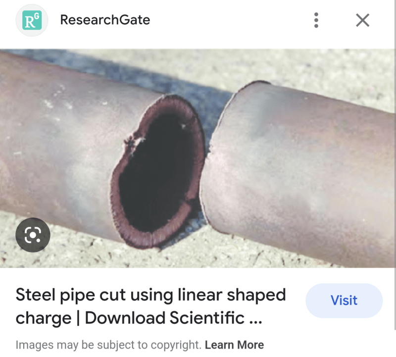

I was hoping to demonstrate with the photos that the pipe could be severed without any deformation using shaped charges or explosive plasma jet. Any distortions of the metal are not necessarily indicative of the direction force during an initial event.
1503 also keeps mentioning the energy stored within the pipeline was sufficient to cause the seismic events. These are important things to consider. The "experts" have all been wrong so far. A big bomb would have caused much more deformation.

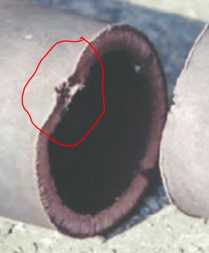

If you look at Tugs picture it could make that fold in the spot where the explosive wasn't applied all the way around, even though it isn't as deep as on the NS1 pipe.
So maybe it is possible. [ponder]

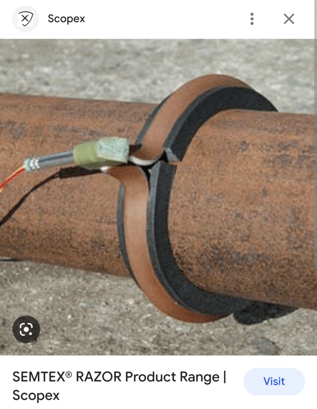

Must admit it's tickled my imagination what it would do on a piper at that pressure of gas.

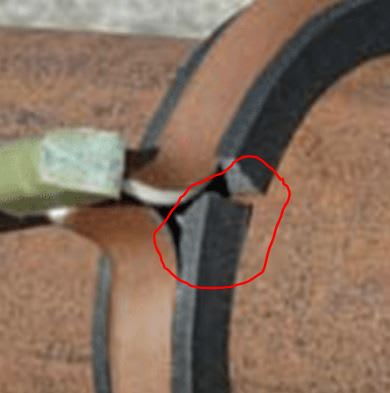

Btw that photo the copper colour stuff is det cord which ignites the explosive black stuff.
The reason why there is a hole is its more powerful than the blacks stuff and they have used some plastic as an igniter. So there is quite a bit more bang in that area than the rest.
The silver thing that looks like a thermo couple is an electrical detonator. What the black wire is I have no clue
Shadow
Thanks was looking at it on phone. Makes sense.
We didn't fire them with electric we used slow fuse or bruised knuckles Straight onto det cord.
