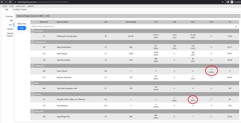

Here is the element level data.
All 4 steel columns were at condition state 4 (severe)
2 of 4 movable bearings were at CS3 (poor)
I would expect that having a CS4 condition on a primary structural element like that would have triggered a more detailed structural review. I don't know the policies in PA though or how city-owned bridges might follow it.

How are the reduced posted weight limits determined in these scenarios? Is 26 tons chosen through detailed structural analyses assuming certain failed members or is it a judgement call based on the types of vehicles that they want to prohibit?
It makes one wonder how they decided that the cross member required supplemental measures but the column didn't.
Someone would have had to completed a structural evaluation (inspection and analysis) to determine the load posting. They would have modelled failed connections, section loss, verified material strengths, etc.

It goes through a certain structural analysis program for the load rating of bridges, in accordance with the FHWA and state DOTs.

When a bridge has important structural items at "needs fixing" it should surely be closed and fixed (or removed, if it's redundant) kind of immediately? There's no point having inspection regimes and rating of safety levels (which actually seem to have been followed quite well in this case) if you don't actually do the repairs they flag up.

Well at least they could have closed a lane on each side. Damn. Also those columns are covered in rust. That break in the cross member should have been the moment you shut the bridge down and fixed it.
