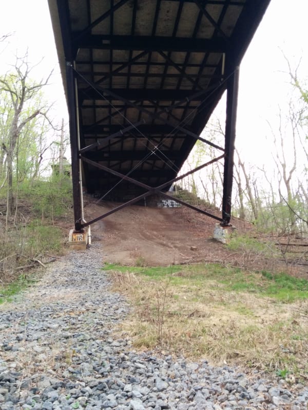

The cables may have been an attempt to stabilize the structure after the bracing became unreliable. Not something I would consider, except for an out of service structure, while awaiting or during a rehabilitation.

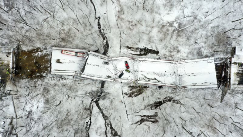

the east side of the bridge appears to have ended up much further from its abutment than the west side. for reference, the 2018 twitter photo was of the west side, but you can the same similar cable remediation on the east side as well in the streetview from the trail below bridge, taken in 2020.
in this photo, the east side is on the left with the bus and the west side is on the right, using that gazebo at top right for reference. the broken section the bus is on appears to be the only section that ended up underneath another section of bridge. 35 mph zone so the bus is taking about 7 or 8 seconds to get that far across the bridge.
Could that be enough of a clue to indicate which side failed first?
are either of these plausible failure modes?
-East side (bus side) columns fail first as the bus load reaches them, deck breaks at the column and the bus section kinda pivots as it falls due to some resistance still there at the columns, then slides down the hill before stopped by other debris, everything else just falls mostly straight down as its way too much load for the columns to provide any resistance now.
-West side column fails first, falls more straight down and pulls rest of bridge down towards it as it fully collapses, causing east side to be so far away

I think that's due to the fact that a good sized portion of the deck folded up into a vertical position. (The back of the bus is resting against it.) Had that eastern end of the deck landed flat on the ground beneath, that distance might look more similar to the other end.
Looks to me like it's the cross bracing on the west end that's missing. The gazebo, while hard to see, is discernable between the column and deck, at the left side.

That doesn't account for the column issues, though. Maybe the ineffective bracing meant the columns weren't doing much to begin with? If the inadequately-braced columns were shedding load to the girders, maybe the failure initiated in the girders, causing them to fracture and result in two cantilever spans that immediately collapsed.
