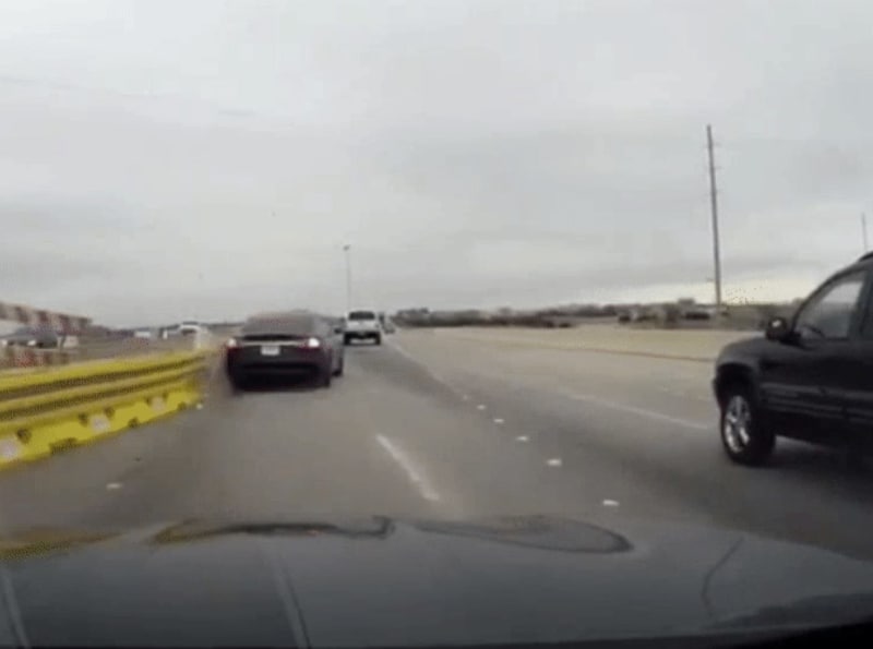

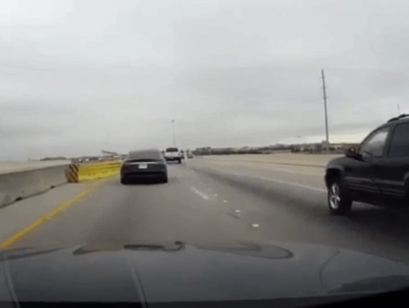

And another report of a self driving car hitting a median wall. This time it appears it lost track of the lane markings.
Missed this one of a Tesla driving into a median wall from last year as well (gif/video):
The solution to these Level 2 autonomy problems seems very straightforward as Cadillac has demonstrated. It's as simple as active-driver monitoring and geofences to only allow system activation in well-mapped and controlled access environments.
Seems pretty stupid for a smart car.
I have been following the progress of self driving cars since the DARPA challenge DARPA Grand Challenge in 2004. It's interesting because it's the first widespread application of AI in a largely uncontrolled real world environment. Road vehicle fatalities are a big killer, and anything to reduce them should be encouraged. But the question is will people accept fatalities as a result of self driving cars, even if it reduces the overall rate? Computers might not make the same dumb mistakes people do, but will make dumb mistakes computers make.
We inevitably hear more about failures than successes. I don't have any stats, but this video shows a few of the times Tesla's have managed to avoid accidents. Tesla Autopilot Predicts Crash Compilation 2
I'm a bit dubious that self driving cars will ever reach Level 5, without changes to road infrastructure to support them. Unfortunately with self-driving cars, they can't be trained in a simulator, they have to be trained in the real world. At the moment, public opinion and authorities appear to favor their development. As the limitations of the software become more apparent, the tide of opinion may turn against experimental software being tested in the field when it has fatal consequences.
The Dallas incident is similar to the San Jose one, where the Tesla seems to mindlessly follows the lane markings, without doing much in the way of even paying attention to the fact that the right lane marking either disappears or diverges to the right.
The Tesla software supports the case where there is a lane marking visible on only one side, the lack of a second lane marking isn't necessarily an error.
In the case of lane markings diverging, how does the software know _which_ lane marking is the "right" one to follow? Either one could be incorrect. Tesla explained that collision avoidance is not signaled to the driver if the driver can safely steer away from it, but that does not appear to be true based on the youtube video.
