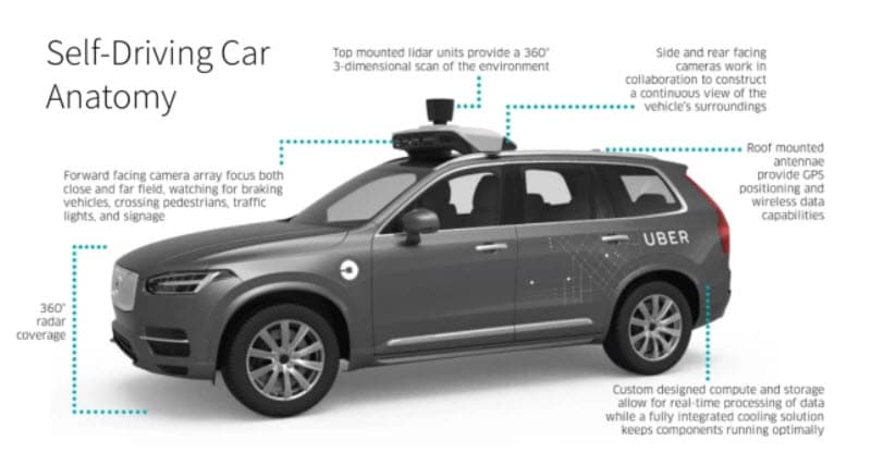

Technology vs Humans. Engineers Seek Answers in Uber’s Fatal Self Driving Car Accident, article in Engineering.com
Roopinder Tara
Director of Content
ENGINEERING.com
While "Operating at frequencies outside the visible spectrum, LiDAR should have given the Uber vehicle a full “360 degree 3 dimensional scan of the environment,”" isn't technically incorrect, most people would use "wavelengths," instead of "frequencies" as light is more typically referred to as wavelengths.

The big problem facing a robot car is traffic. Traffic is unpredictable. Robot traffic will provide all sorts of non-specular reflection of LiDAR wavelengths that your LiDAR will have to filter out.

Not really the same thing. LIDAR uses millions of laser beam pulses bouncing back from objects. What happens when there are several LIDAR systems operating in the same area, all bouncing laser beams off of their surroundings? How does each LIDAR sort out its laser beam reflections from the others?
The main factor in lidar is the narrow field of view of the receivers and the narrow time they are expecting to have a signal return. There is a similar problem in flash photography where a crowd is taking pictures. It is possible to have two or more flashes go off during the exposure, but it is relatively rare and subsequent images aren't likely to have the same problem; this is the case where the exposure was 1/60th to 1/30th of a second. The duration of exposure for lidar is much lower.
One of the bigger problems is for microwave systems that have much larger viewing angles.
I suppose the ultimate answer will be what Ethernet did for communications over co-ax. Each Ethernet adapter would listen for any ongoing traffic and would start transmitting when it was clear. If two adapters started at the same time the conflict would be detected and they would stop for a random interval before retrying. This might be milliseconds of delay, so just a few inches of vehicle travel.
The field of view of the receivers are sized specifically for the ranges and scan rates on something like the HDL64, so it's on the order of milliradians. Interference requires another laser hitting essentially the exact same spot that your laser hit at exactly (within TWO microseconds) the same time. Despite claims of dozens of lidars interfering, realistically, it'll be on the order of 6. In, say, bumper to bumper traffic, distances are reduced, and masking by adjacent cars prevent the cars behind you from hitting most things in front of you. In sparse traffic distances are increased, but there are fewer cars emitting.
Moreover, as I stated, there are a variety of existing solutions to co-channel interference, such the pseudo-random number codes used on GPS, or the Tri-Service code used for laser designation systems such as the Apache Target Acquisition and Designation Systems (TADS). As you might imagine, if you fired your Hellfire missile at a target you designated, you wouldn't want it to get distracted by someone else's laser designation for their own Hellfire. Which is why there are hundreds of different codes that Allied forces can use and not interfere with each other. Additionally, the Tri-Service code that the Hellfire uses also has a rolling code that's comparable to garage door opener rolling codes called Pulse Interval Modulation (PIM) codes. There are billions of possible PIM codes. The receiver basically uses a temporal matched filter to look for the code that it's programmed for, and ignores other pulses from other emitters with different codes.
