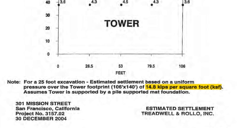

DeSimone's project foundation calculations submittal gives a load of 14.8 ksf for a 106' x 140' piled foundation. The plan view submitted by Lera/ENGEO for the previous solution, the symmetrical piling upgrade, was for the as-built, 103' x 153' piled foundation for 14.58 ksf.

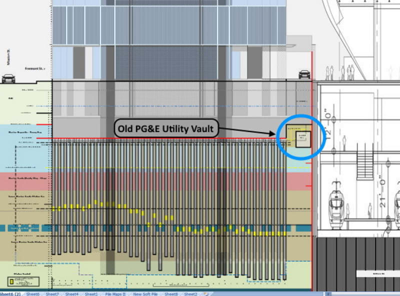

A proper representation of the piles in profile along Fremont St. shows the shortest spec'd piles, don't reach a sand layer, based on Treadwell & Rollo's original bore logs.
The yellow points represent 2/3rds the pile length, exclusive of the mat.

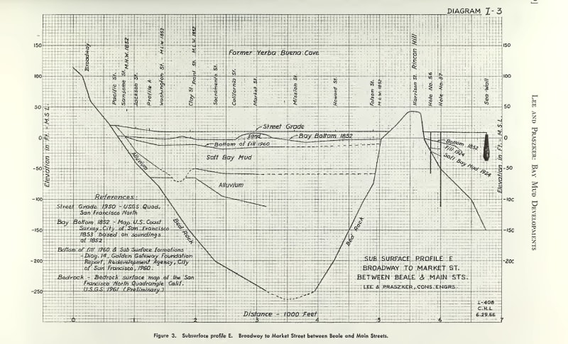

Is this what we're looking at? Looks really good for liquifaction...
The tower is between Mission & Howard but yeah, they are right over the middle of the ravine.

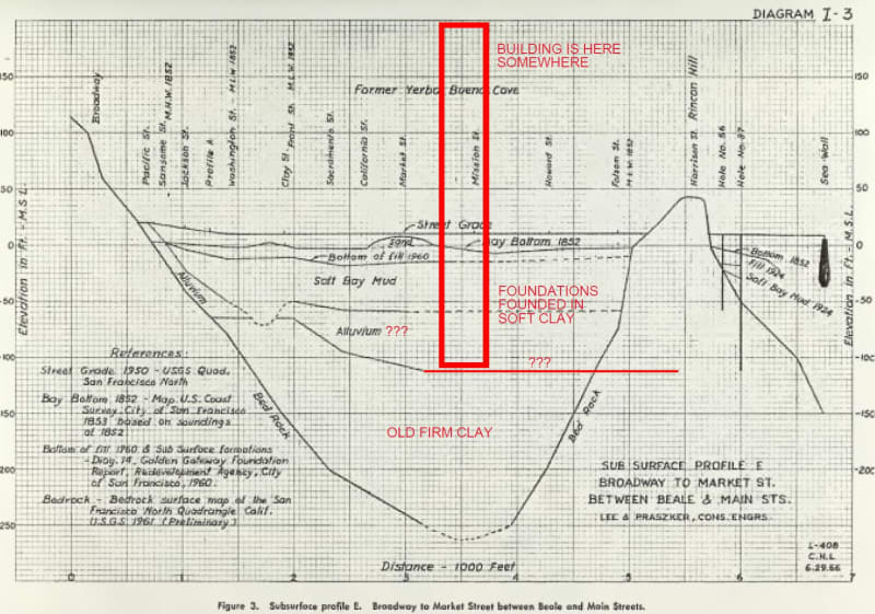

A geotekkie may have a better handle on the foundations; I've only done a few seismic projects and none of them where liquifaction was an issue. Doesn't look good from here, and the red box sticks up 3x as high. It's time they got 'the big one',too. I don't know if the building is to scale horizontally... just a WAG.
Millennium Tower is 645' tall, 150' wide on Fremont Street, and 110' wide on Mission Street. Dimensions approximate.
The proportions of the above ground part of the red rectangle look right to me.
The red rectangle has the below grade part at about 415' deep. THAT seems a goodly ways off.
spsalso
I thought the piles were only about 100' long, not 400', and that bedrock was about 200' down.
"I thought the piles were only about 100' long, not 400', and that bedrock was about 200' down."
Ah, I see where I made a mistake. The top of the red rectangle is NOT the top of the building, though it DOES seem reasonable to assume that. Over on the left, there's a height scale, with the top of the rectangle ending at about 200'. So the building got several hundred feet chopped off, so as to fit.
The piles do seem to be the correct length at about 100'.
And since the x and y axes are not equivalent, the assumption that the proportions would be equivalent is incorrect.
The red rectangle's width, however, is incorrect. In the drawing, it is about 500', as opposed to the more correct width of 150'.
