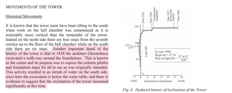

"The man who saved the Leaning Tower of Pisa, By Andy Pearson 14 September 2000" with this link:
The man is John Boscawen Burland CBE FRS FREng (born 4 March 1936), an Emeritus Professor and Senior Research Investigator at the Department of Civil and Environmental Engineering of Imperial College London.
Part of the story quotes him as :
"The problem Burland faced was to correct the lean without causing the tower’s collapse. The tower was so delicately balanced that the team charged with saving it dared not touch the ground on the south side, the direction in which it leans. “It was not an underpinning job,” says Burland. “Any interference with the ground on the south would have brought it crashing down – and I’d have had to take up selling ice-creams in the piazza,” he jokes."

I visited the Pisa tower in 1990's when they were doing the retrofit with a European colleague who was involved with the international team led by Prof. Burland. The solution was, as explained in the story, not to touch the soil under the building, especially on the south side that was settling more and causing the tilt. But in Millennium Tower, these naive Designers, and Peer Reviewers of the design, have done just that, disturbing the soil under the side that is tilting (the N & W side). In Pisa Tower, they had added weight on the north half of the foundation opposite of the side that is settling. I took pictures and if I find them I will post, but, for now, enjoy this historical evidence (not really!) below of how the engineers made the King happy by saving him some money! Maybe the designers of the N&W pile solution and their peer reviewers tried to make the Millenium Tower developer (Millennium Partners) happy, instead of trying to make the building safe for a major earthquake regardless of how much it will cost, or if it cost too much and not technically doable, pay the owners the value their condos had before the tilting was detected, evacuate the tower, demolish the tower (very slowly and carefully!) and rebuild it correctly or turn the lot to a nice park! This approach will satisfy the first Canon of the NSPE Code of Ethics for Professional Engineers which states: "Engineers, in the fulfillment of their professional duties, shall hold paramount the safety, health, and welfare of the public."

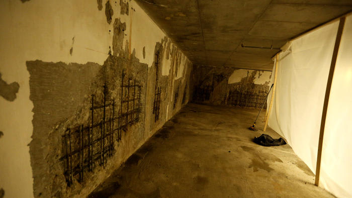

The photo of the repair work is actually from the parking garage and it may be the 5th/bottom floor of the garage, involving the north wall of the parking structure. You can just make out the paint for a parking stall.

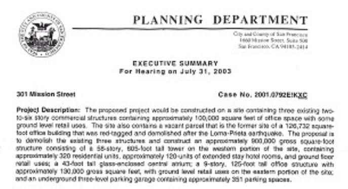

Does anyone have a copy of this correspondence; it seems to have been pulled...
I haven't seen that document but from the project description, it is the 'Original' tower. The original tower had 4 basement levels across the entire site. Think partially compensated foundation. It was also described as sitting on a mat foundation & tower piles.
The original design did not present an excavation problem for the TJPA.
Millennium wasn't able to get PG&E to move their existing utility vault under the old 129 Fremont. If they tried to build the existing vault into the basement tower, the first two floors of the basement would add up to -25 feet of excavation. Instead, they cut 3 floors off the tower basement and added a 5th to the Podium/Mid-rise. They went as deep as they could for 1 basement level, then went with a cantilever slab over the old utility vault and built a new utility vault in the basement of the tower to replace the one they were building over. Building over an PG&E easement isn't allowed. So they replaced it with the one now in the tower basement. The new scheme was Webcor's idea.
Final EIR gives the same project description. It changed in 2005, just 10 days after the TJPA received final approval for the current alignment.
It is odd that, that Planning Dept. document didn't end up in the Final EIR.
