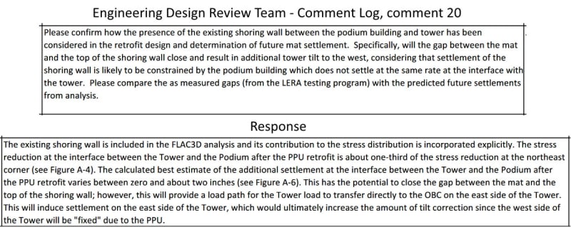

The other proposal, by Karp-Kardon, also had some unknowns/complications.
Here is a complication regardless of remedial scheme.
It is a very big assumption that the shoring wall would settle along with the tower. Then, there is the entirely new seismic response that goes without discussion.
When the news broke that the retrofit was being paused, the new amount of settlement was given as 2 inches & 5 inches of tilt. Since then, the media has been saying, 1 inch of settlement. SF Supervisor Peskin is still saying 2 inches.

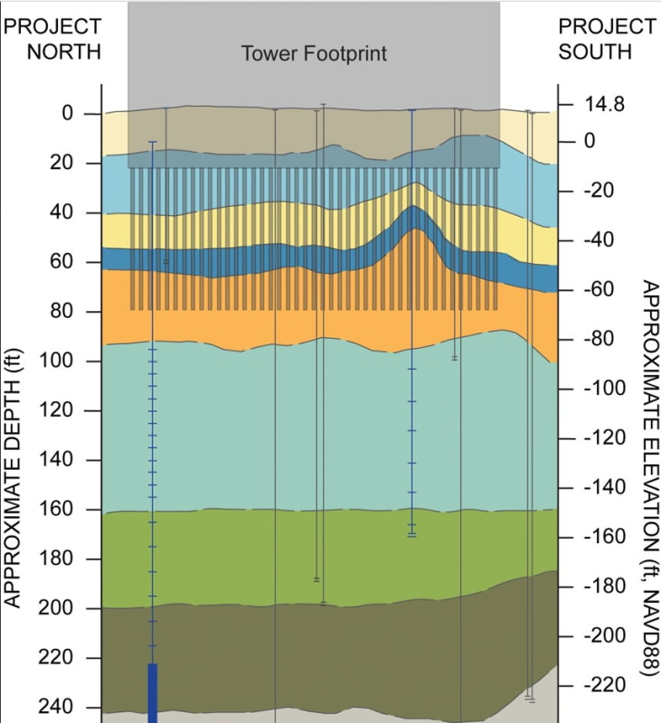

I wonder if the perimeter piling has reached the Colma Sand Hump yet?
Here is a link to the retrofit monitoring plan by Slate. Courtesy of LB Karp's Millennium Debacle webpage.

Here is a hydrological study of San Francisco and an excerpt I thought was worthwhile.
Geohydrology, Water Quality, and Estimation of Ground-Water Recharge in San Francisco, California 1987-92
Excerpt:
Modeling from SF Municipal water table recharging results indicate that areal recharge rates for water years 1987-88 for the seven ground-water basins range from 0.32 to 0.78 foot per year.
• Modeling from SF Municipal water table recharging results indicate that areal recharge rates for water years 1987-88 for the seven ground-water basins range from 0.32 to 0.78 foot per year.
• A comparison of the highest horizontal hydraulic conductivity (31 ft/d) with the highest vertical hydraulic conductivity (5.1 ft/d), which can be assumed to occur in the same materials, indicates that the minimum horizontal-to-vertical anisotropy may be about 6:1. The range of horizontal (5 to 31 ft/d) and vertical (0.0018 to 5.1 ft/d) hydraulic conductivities indicates that the coarse-grained deposits that control horizontal flow are relatively continuous, and that fine-grained deposits that control vertical flow are relatively discontinuous. Storage coefficients (table 1) indicate unconfined conditions at depths less than 100 ft (0.01 to 0.32) and confined or semi-confined conditions (0.00024 to 0.0082) at depths greater than 100 ft.
• A linear relation between rainfall and runoff from pervious areas was established such that a threshold rainfall amount had to be surpassed for runoff to occur. The threshold value was assigned based on soil type, ranging from 3 in/mo for clayey soils to 9 in/mo for sandy soils, with a slope of 0.9. [End]
It would have been nice for everyone if a decision had been made to work with only one Elevation reference. It is impossible to keep track of groundwater elevations when they keep switching between bgs, NAVD88 & SF Datum.
