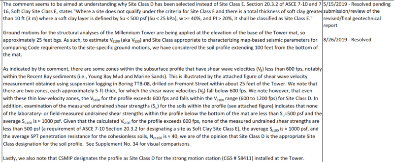

Going back to Hamburger's responses to Pyke, which I posted above. Here is a specific example of obfuscation. First we need to see the prior response in Comment No. 34, which is referenced in Hamburger's first No.1 but was not included.

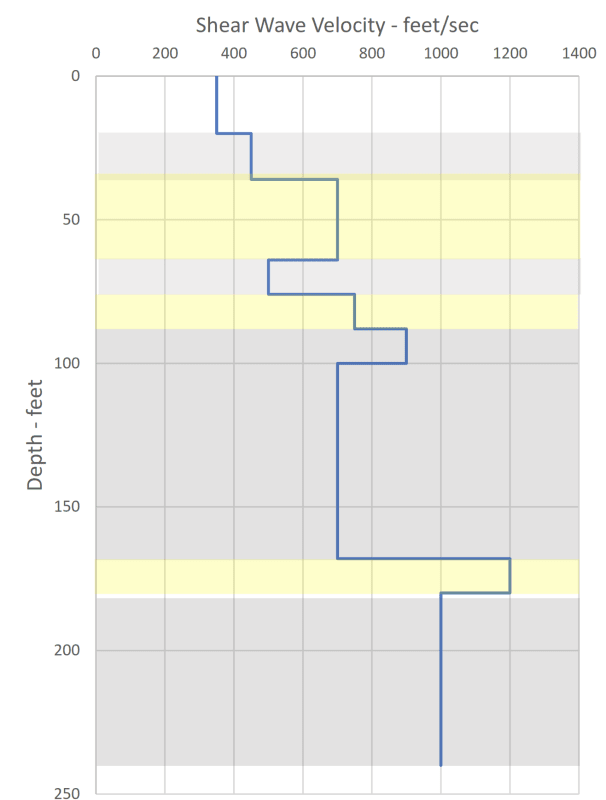

That text from the Comment Log refers to two figures that were included in Supplement No. 34, one of which is a shear wave velocity profile obtained in a nearby boring for the new bus station:
But in 2018 in the Egan / Slate geotechnical report it is indicated that the shear wave velocity profile that they used for analysis of the site response was as shown below - note the softer top which makes it Site Class E - the input motions for the structural analyses were defined at the base of the perimeter mat but the building code says that site classes are "based on the upper 100 feet (30 m) of the site profile" - the building code generally does a poor job of coping with embedment but that's another story:
And the ERDT signed off on this reply ????
There is a reference in the comment log to an updated geotechnical report in 2019 but I have not seen this and I don't think the shear wave velocity would have been changed. Why? Because another dirty little secret is that the Slate site response analyses were so bad that SGH ended up using the site response analyses, using this same profile, that had been done by ENGEO for LERA! This is noted in the 2018 Egan / Slate geotechnical report and elsewhere.

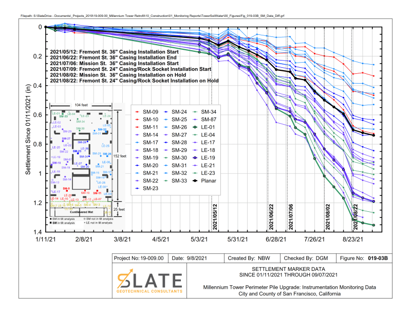

Here is another nice plot from Slate:
So, why did they not put the installation on pause by say the end of June when it was obvious things were going off the rails? Likely they would still be digging themselves in deeper were it not for Jaxon vdB's initial report on NBC Bay Area news.
