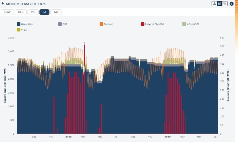

Typical predicted shortfall in supply is 300 MW. here for example is what the energy overseer predicts for the next couple of years. You do the maths with a 100 MWh battery
Cheers
Greg Locock
Greg... looks like you need three or four of them...
Dik
I /think/ that graph is the average power draw over a 24 h period, in which case a 100 MWh battery is not even going to make a dent in the shortfall.
Cheers
Greg Locock
Isn't the point of the battery just to carry things long enough to get some big generators up and online or as carry thru cuz a cloud passed over a large solar array? In that case you can suck 500MW out of a 100MWhr battery for a short while. The size of the battery just offers the dispatchers more options ranging from do-nothing ride-throughs to crank up a coal plant.
