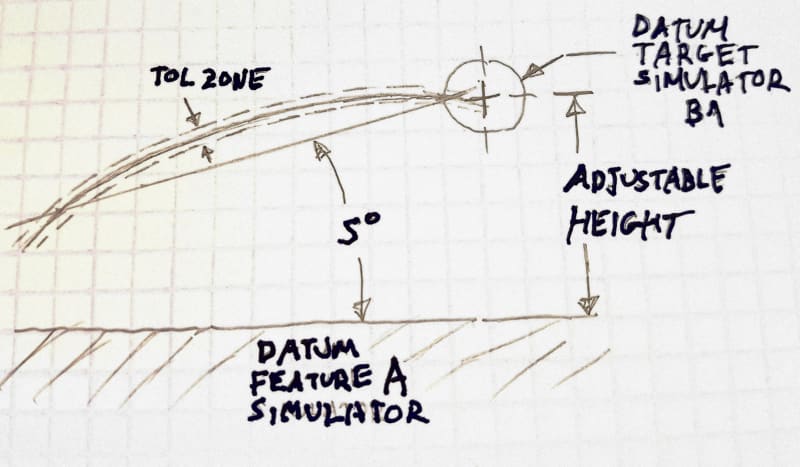

Dean, here is my suggestion.
I think that the directly toleranced dimension used for location is less ambiguous here than it usually is. Notice the dimension origin symbol and the defined measurement location.
Datum target B1 is a datum target line and it is movable normal to A. Therefore the tolerance zone that is connected to it can be adjusted to correspond with the height of the feature to be best-fitted into it. This way there is no location control by the profile tolerance.
The important thing here is that the basic angle is meaningful in this scheme because there is a defined "anchor point" to which the intersection between a theoretical plane slanted at the basic angle and the true profile must be aligned. This "anchor point" is of adjustable height and doesn't force location.
Drawing:
(Forgot the datum feature symbol for A. It is the bottom face)
Datum feature simulators and tolerance zone:
Burunduk,
I agree that your approach, using dimension origin (one of those things we have that enables saying the same thing using two different methods :-)) avoids the ambiguity associated with a directly toleranced dimension with arrowheads included on both ends of the dimension line.
Why is this better than a composite profile tolerance, or two separate profile tolerances, with one releasing the vertical translation that datum A will constrain by using a customized DRF?
I think datum feature A being referenced by the profile tolerance in your example, then somehow the constraint it provides in the vertical direction disappears when the directly toleranced dimension is added instead of a basic dimension is illogical.

I generally agree and there probably are better ways as you mentioned. I just tried to stay as close as possible to the original scheme that was discussed ("profile controlling orientation" in CH's posted figure) which involved a toleranced dimension.
I say that datum A does not provide a useful constraint in the vertical direction regardless of the toleranced dimension, because there is no basic distance dimension in this direction :-) (assuming it is a regular drawing and that it isn't supposed to be used with a CAD model for full definition).
