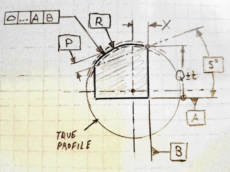

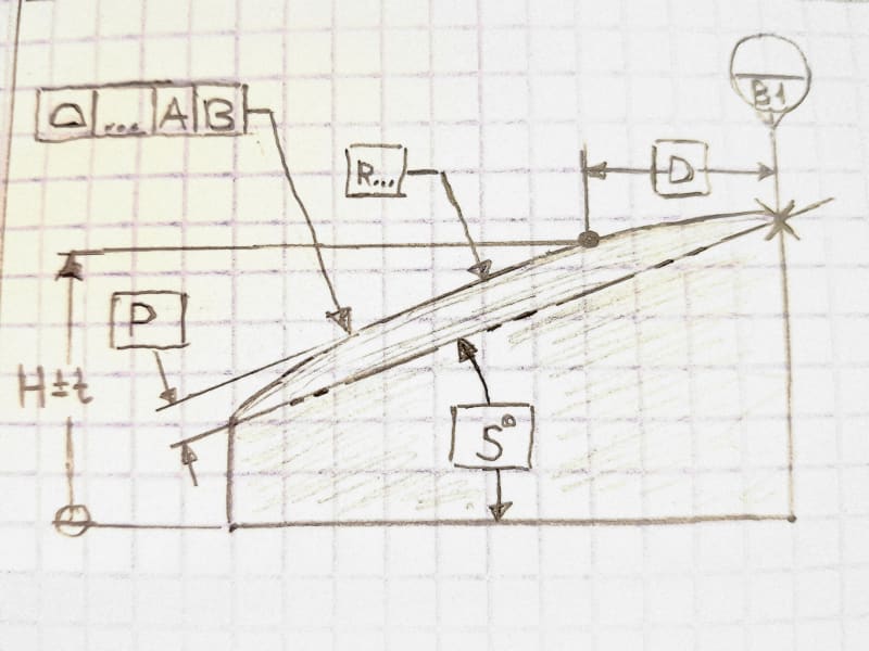

Or another perhaps more questionable option - keeping the height to the upper right corner toleranced as in the original graphic posted by CH and considering it as the size between "a set of two opposed parallel
line elements". As long as the movable datum target B1 is used and B is referenced as in my proposal, it should prevent the problem and the profile tolerance would define the geometry without controlling the general height of the feature relative to A (setting the "arc orientation" as intended).

Let's start off by agreeing that the second portion of Henzold's graphic is legal, correct, and actually identical to parallelism. I realize that it might not be popular with some, but it is not ambiguous. That's why I'm OK with profile for form/orientation, and ± tolerance for location, on a nominally flat surface.
When we move to curved surfaces, my initial thought was that it should be OK, as CH offered in that graphic dated 24 Jun 20 18:38. But you went to great lengths to show how that would not be acceptable, because of the full-circle idea and the notion that the arc we are sampling could be rotated, thus making its orientation to the viewer seem unacceptable. And thanks for that good discussion :)
Now you have modified that same picture to maintain the ± tolerances for location/height -- and profile for orientation/form -- while fixing the rotating-arc problem. However, I don't think your modifications will work, so I'll still stand by my general statement that you've quoted above.
Here's why I hesitate about your graphic from 26 Jun 20 21:36... Your movable datum target point is meant to help determine the ± height (or correct me if the intent was to have the ± height help determine where B1 is). But datum B is only of use to a callout that specifically references datum B. The dimension with ± tolerance doesn't "know" about datum B; it only works as a direct linear measurement -- so it's good you have the dim origin symbol, but that can't be linked to the distance from the right-hand surface.
In other words, your attempt to find that big dot has the same issues as the classic old-fashioned hole which uses ± location: We can't locate off of two "datums" unless there is a DRF created with priority among the datums.
That's a very good point, thank you for bringing this to my attention - I agree.

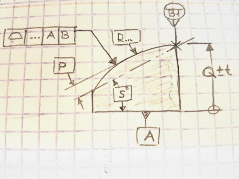

What would be your opinion on the scheme shown in the sketch below? A different modification of CH's figure.
I think that it is pretty straightforward with the dimension origin symbol that the upper right corner shall be located so that no low point on it is below Q-t from a tangent plane of the bottom surface and no high point can be above Q+t from that tangent plane. I say "tangent plane" and not datum A on purpose (naturally, most chances are that the simulated datum A will be used as the tangent plane in practice, but the drawing does not create a bond between the +/- dimension and the datum). If the size tolerance is loose enough (the only case where the entire scheme makes sense), it shouldn't be an issue if the corner comes out relatively sharp or significantly chamfered, it should still be within that 2t zone in its entirety. The datum target B1 shouldn't be accurately coincident with any element of the corner. It is adjusted at height and used as a movable anchor for the profile tolerance zone, to allow best-fitting of the entire arc surface. Thoughts?

Let me ask two questions: First, can I presume that the movable datum target B1 is a line? (It can't be a point because that wouldn't stabilize the DOF needed for a secondary datum in the FCF.)
Second, what is the purpose of having a movable target there? Maybe we could just label that entire vertical surface as datum feature B.
For your other question, yes I think I would be OK with profile of a surface used to control form/orientation for a nominally flat surface even if it's not parallel to the datum. Similar to what I wrote to Dean about parallelism: take any classic angularity drawing from a basic GD&T textbook (a flat surface angled to a single flat datum), and just replace angularity with profile of a surface; it's the same meaning.
I myself wouldn't do that, but it would not in any way be ambiguous or illegal. So it's just the darned curves and other non-flat surfaces that require extra thought, in my viewpoint.
Yes. I didn't show an additional view to depict it as a line but I mentioned in the post where I embedded the first version that it is a line. You are correct about DOF - a point would not be good enough to constrain the rotation about an axis normal to A.
I thought of a movable target line because that's the minimum that is needed to create an adjustable reference to which to tie the intersection line between the true profile arc and the slanted theoretical plane (at basic angle) to prevent the floating which causes the issue.
However, I should have thought about designating the entire surface as a datum feature as you suggest. That makes more sense because it is more straightforward and easier to accomplish in practice. And the intersection of the theoretical geometry should simply be aligned with a secondary datum plane.
Thank you for pointing that out.
So would you agree that if the datum target symbol in my last graphic was replaced by a datum feature symbol applied on the right-hand face, that would be a reasonable way to specify profile for "orientation" (as intended in CH's original figure) of an arc in conjunction with a +/- tolerance affecting the location of the entire feature?

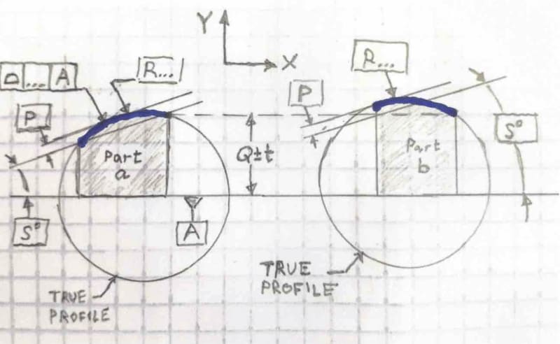

Before I accept your conclusion, allow me to "talk out" why the addition of datum B might control the orientation. I'll refer to the earlier picture where you explained how the arc could appear "disoriented" while still falling within the profile zone:
I believe that we accepted that idea -- that both of the blue arcs are within the profile tolerance zone -- for two reasons:
1... There was no way to "clock" the portion of the arc we wanted, since the true profile is merely a radius.
2... Because the axis of that imaginary circle could translate, thus allowing a new portion of the arc to be within the physical boundaries created by the two vertical sides of the part.
Now, by adding datum B it looks like you are eliminating reason #2, and if the axis can't translate left-right, then I suppose it would always force the same portion of the arc to be within the zone.
If that's all true, then I would say that your latest graphic would need a basic dim from datum B to the axis of the imaginary circle. The final result: The profile would be controlling orientation from A, and location from B (as well as form).
What are your thoughts on all this?

I believe that the two reasons you mentioned for two differently "oriented" arcs that would be within tolerance as we agreed are actually one reason. The allowed shift of the true profile axis parallel to the XY plane, even when keeping the height of the upper right corner constant, is what causes the inability to "clock" the orientation of the arc, while different portions of the true profile and tolerance zone can be used to accept the produced geometry.
By adding datum B I am not eliminating one reason out of two, but the entire problem.
Regarding adding a basic dimension from datum B to the axis of the true profile - is it mandatory? Please refer to the following graphic. Would you say that if the basic dimensions R (basic radius), P, and S are known, the geometry is still not fully defined unless you specify X? I would say that a single resultant value of X would be defined for any given set of the other parameters.
axym, we do not have to extend the true profile to a full cylinder. It is enough to use a sufficient arc length of a tolerance zone, larger than the produced arc, to allow different "orientations".
