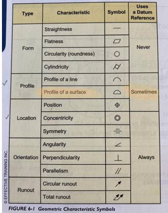

Here is the table from Alex K's book that states that datums are sometimes used as a reference with profile of a surface.
The question is when?
me said:
define a tolerance zone and, if required, fix that zone in orientation and or location relative to other features
Datum feature references are used if it is required to fix that zone in some orientation and or location relative to other features.
Radius1,
Datums are used in a surface profile tolerance whenever there is a desire that the tolerance must control orientation and/or location of the surface with respect to the referenced datum(s).
In absence of any datums, a surface profile tolerance is only capable of controlling form and potentially size of the toleranced feature. But if the toleranced feature is a flat surface in nominal, like in your example, then the only characteristic of the feature that it controls is form, namely flatness.
