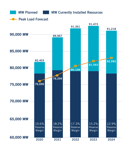

What makes you think that spinning and non=spinning reserves aren't compensated?
What makes you think that RRCOT doesn't have adequate reserve margin?
Maybe because of this.
Estimate was for this winter’s electrical load of about 67,000 megawatts.
But the shadow estimates published by ERCOT suggested about 72,000 megawatts of peak demand.
ERCOT has the ability to supply electrical capacity of about 80,000 megawatts.
ERCOT runs “light” in terms of electric system reserve capacity with reserves typically about 8%.
This compares with other US grids where targeted reserve margins are about 15 %
Best Regard A
