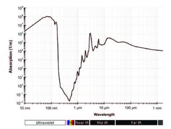

You need to stop using the term 'reflected' to describe an absorption/re-emission process. They are fundamentally different.
And, generally, no. The radiation absorption spectrum of water has a gigantic peak in the IR band. The IR emitted by the water, absorbed by the CO2, and re-emitted back toward the ocean surface is almost completely re-absorbed again.
This is the absorption band for liquid water at 250C. Notice the valley in the visible band, which allows water to be transparent. Note how the lowest absorption value on the whole plot is right over the blue part of the visible band. This is why when you're deep underwater everything is visible in shades of blue only - all other wavelengths are absorbed.
Then notice the giant absorption values in the UV and IR bands.
Does the wavelength of absorbed and re-emitted IR change or is it re-emitted at the same wavelength?
Edit: I am reading that CO2 most strongly absorbs at the 15um wavelength and so does water so it falls back to water not reflecting much IR. This means the oceans would see less effect from the greenhouse effect.
