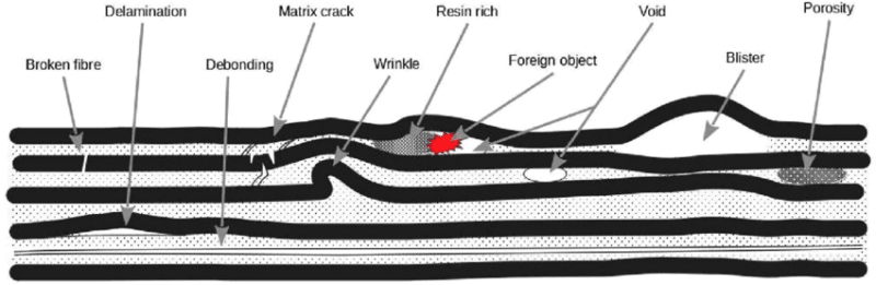

I Found a graphic with a list of lots of things that could have gone wrong with a composite material. I'm actually surprised the Titan held up as long as it did. Pick your favorite combination of flaws that could have led to disaster at that depth.
Good spot Murph!
