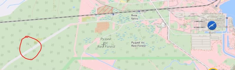

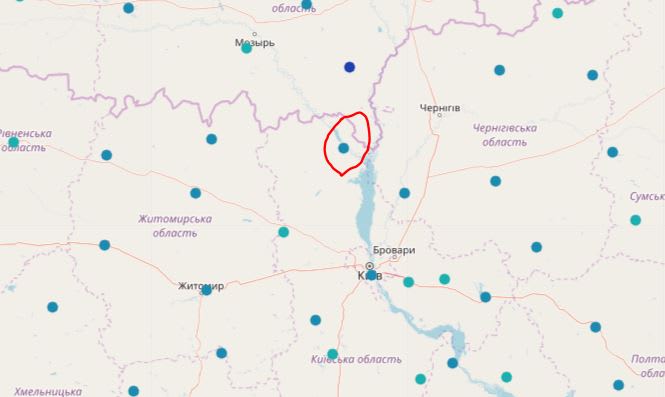

The "red forest" is named after the reddish-brown color of the pines in the area since they died of high levels of radiation after the Chernobyl accident on April 26, 1986.
After the disaster, the forest was cleared and the trees dug down.
The Red Forest is today one of the most polluted areas in the world.

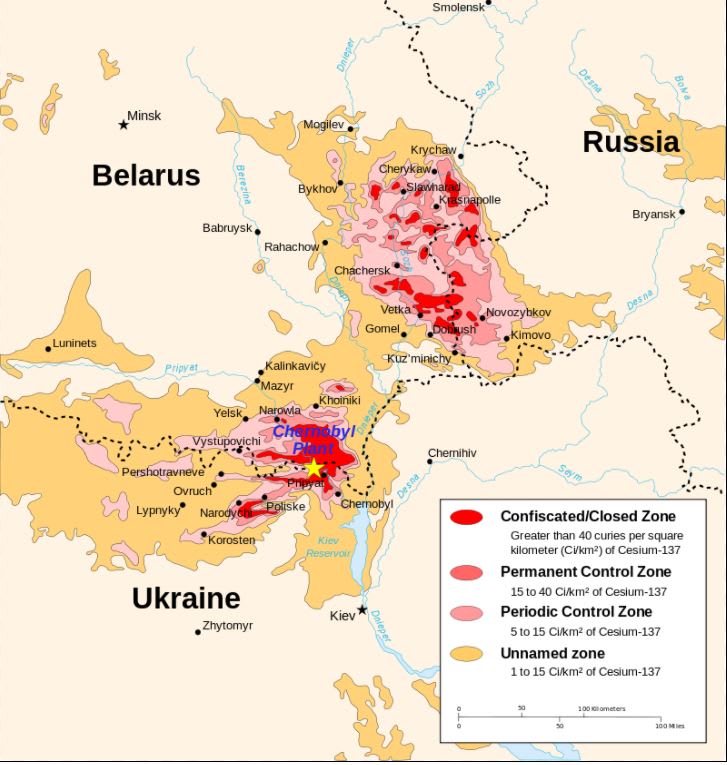

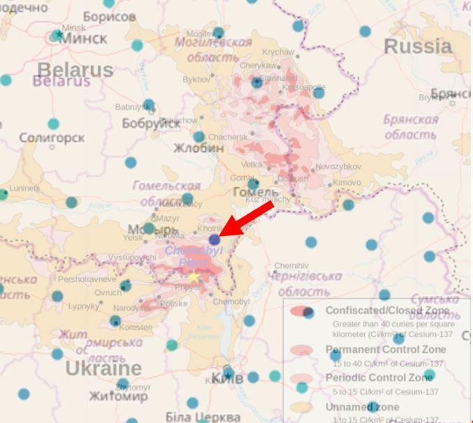

In this image I have put the current measured values on top of the old Curies per km map
The arrow points at the highest measuring station and the value is right now 460 nSv/h
From our guidelines below making this calculation
Take the maximum recommendation for eyes 20mSv/year.
With 0,00046 mSiv/h, one hour would give you 0,00046*24*365 = ca 40mSv/year
And this is not the most contaminated part.
For stirring up dust, I don't know, feels like a exaggeration, it's still quit much winter and wet.
But just being there is not good.
Digging even worse.
