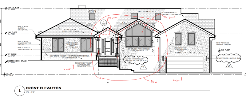

Client wants an open gable roof. I don't like to do it generally because of lateral thrust; I'm more comfortable with having horizontal attic joists. Are there any references for how to design something like this? I was considering having some horizontal timber beams at like 8'-0" on center to deal with the thrust, beyond the window so the structure wouldn't obscure the facade.

@Eng16080 By thrust beam, you mean like horizontal timbers every 6' or 8' or so? I was thinking of that, but I like kissymoose's idea of eave beams because it gives a cleaner look. I don't want to rely on adjacent roof diaphragms because there are two open roofs next to each other. If it was just one open roof, it could work, but two next to each other introduces a bunch of pins.
Ill throw in a Vote for a Ridge beam and and a bent steel header. Do away with the lateral thrust problem all together. Obv, I would like to see the roof / floor plans.

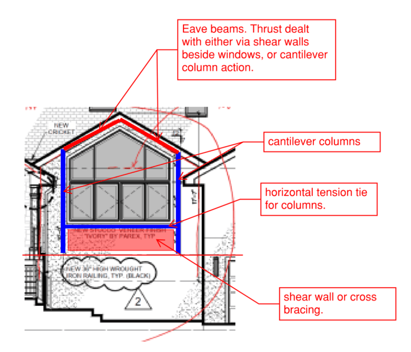

Could you create a shear wall/tension tie and bracing below the window stiff enough and have columns cantilever from the floor framing, past the top of the shearwall/tension tie and bracing

I like jayrods's idea as well. Perhaps you can design shear walls there that work for the thrust. I've used the cantilever column approach, although I usually find that steel is required for that to work.

@jayrod12 That's a great idea, I like it. I think engaging both the shear walls and relying on some cantilever will work.
@Eng16080 Yeah, I don't think the cantilever column will work just by itself. But combined with the shear walls, it should be enough to handle the thrust. Anyway, I've got a tiny bit of leeway because the adjacent roofs have horizontal rafters. I'm not going to factor them into the calculation, but I think they can handle about 15% to 50% of the thrust, so I have a bit of safety.

With jayrod's idea you're still going to need the eave beams to transfer the thrust into each end, else you're relying on the roof sheathing to do so. You'll also need a shear wall or tension tie element at that interior wall, and/or drag it into adjacent diaphragms. With the snow loads in my area I'd be doubtful I'd get a reasonable eave beam to span the 17' for the weak axis bending unless they're good with an exposed timber wider than the stud wall.

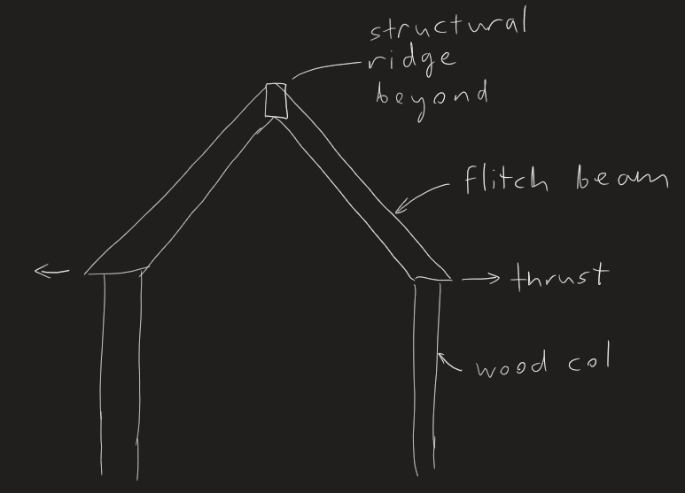

@driftLimiter @alt0 @XR250 I'm having a hard time visualizing this, and how the load path works out to resolve the thrust. Can someone send a sketch or a detail they've used in the past? I sketched what I think you're saying below. From what I see, it's putting the thrust into the wood column, which will need to be engaged by the shear wall.

The lateral thrust will be a lateral load into the adjacent diaphragms connected to shear resisting elements). It won't go into adjacent rafters because there is nothing resisting the horizontal load. The horizontal load must come out somewhere and that "somewhere" will be lateral resisting elements.
