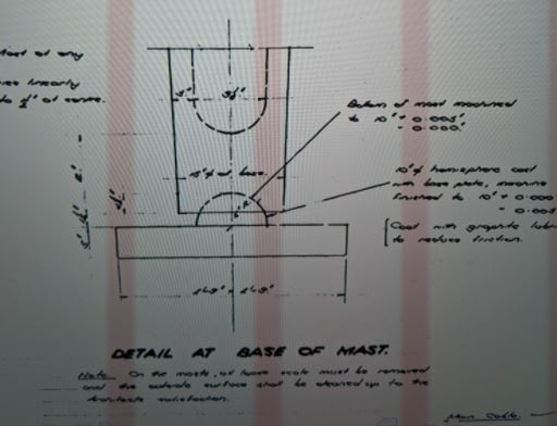

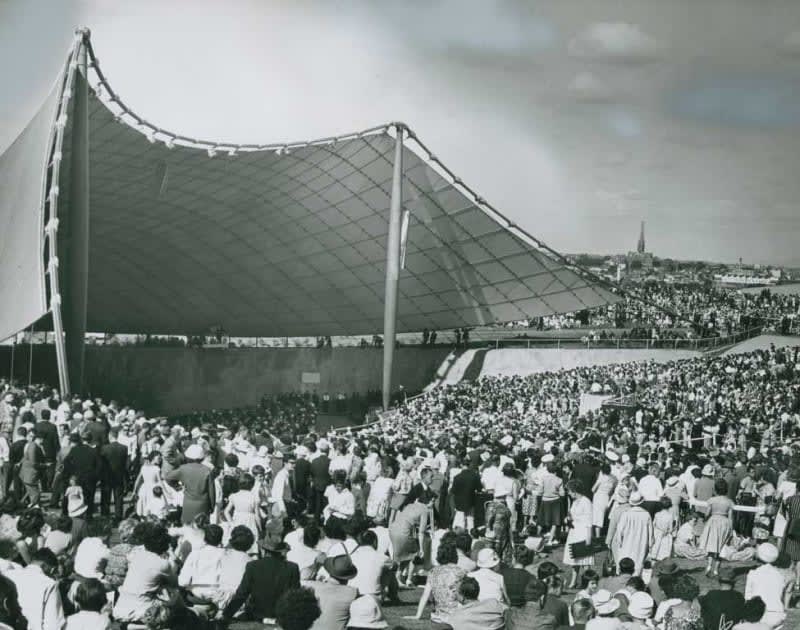

Othertimes you absolutely want column rotation and provide a bearing for it. (I've posted this before, but it is a great and certainly not modern example.)
