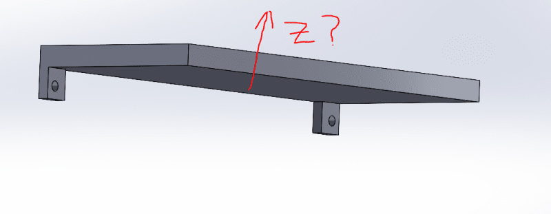

Hello,
I have a part I'm detailing where a large, flat surface is my primary datum (A), and I would like to set two approximately (not quite, due to draft angle) perpendicular tabs as my secondary datum. The tabs have a significant gap between them. I would like to treat them using the method described in ASME Y14.5 Section 4.12.1/Figure 4-23 by calling the tabs datum B and datum C, and then calling datum B-C as my secondary datum. I would locate screw clearance holes (one hole on each tab) relative to A and B-C and name the holes datum D. However, all of the examples of applying Section 4.12.1 that I've seen in the standard and on GD&T websites only shows this technique being used for a primary datum. The one potential exception I've seen is the situation referenced in this post, but whether the simulated datum must be a primary datum was not the focus of the post:
Does ASME Y14.5-2009 allow for a simulated single datum to be applied as a secondary datum? I've attached a sketch to illustrate my question.
Thank you all!
Tim
Hi, donatim24:
You can use Combined Datum features as first, secondary or tertiary datum. However, the Combined Datum features that you selected are not good to control angular rotation DOF (Z direction). I assumed that your datum feature B and C are perpendicular. Please correct me if I am wrong.

Hi Alex,
Thanks for your response. In the example I attached (a dumbed down version of the actual model), the tabs marked datum B and datum C are perpendicular to the surface marked datum A.
When you reference rotation about Z, are you saying that Z runs vertically through datum A (nominally "Up" in my screenshot)? Is the concern that the tabs are so small compared to the width of the part?

Hi, donatim24:
Yes. Z runs perpendicularly through datum A.
Is that true that datum feature B and C are perpendicular to EACH OTHER? If they are, then combined datum features (B-C) is not good to immobilize this rotational degree of freedom.

I apologize for the miscommunication. B and C are coplanar/parallel. I definitely agree that if they were perpendicular to each other, I couldn't use them as a single datum. Datum B and C are located on the wide faces of the tab with the clearance holes passing through them.

I see. Yes. You can use B-C datum features as secondary datum, or tertiary datum if you want to. But you will need an additional datum to locate other features on this part.

You can also use the CF symbol and treat them both as Datum B.

Thanks, Wuzhee. I wasn't 100% sure if I could use CF on a feature that's not a feature of size. It seems the standard (2009) is inconsistent in whether that's allowed.
You can if there is some control locking the two surfaces to each other, such as flatness. Or even Rule #1 might suffice, as is apparently the case in Figure 10-32 of the 2018 standard.
The very minimum control you need is either a Datum Feature symbol, FCF or a size dimension. Then you can further combine them.
It is a FOS. Datum plane B is one size of that thickness, that must be treated as one. This raises the question as whether you want to treat the opposing plane as one surface also...
