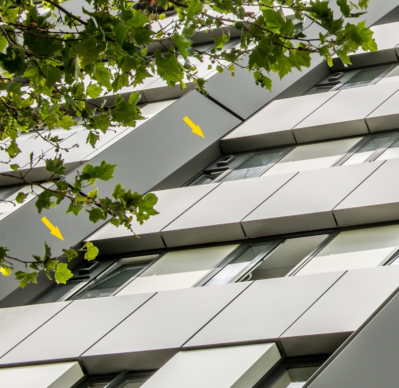

It's my understanding that the issue with cladding material in multistory or high rise buildings isn't just with the cladding material but the entire assembly as a whole - including installation details. Each installation and any additional "layer" to a wall needs to be tested separately because fire can react to each assembly differently.
PIR foam is a thermoset material which means - while combustible, they form a char and doesn't contribute to the spread of flame. That being said, any foam plastic still needs to be separated by a thermal barrier or be tested as a thermal barrier. The ACM material however, is a thermoplastic which can melt and ignite at lower temperatures.
I'm not too familiar with the European codes, but typically foam plastic insulation and metal/aluminum composite materials need to be tested via FM 4880 and NFPA 285. These are tests that measure the flame characteristics of the foam as well as the cladding assembly in multistory buildings. The Grenfell tower installation looked different than what Reynobond has in their ICC-ES report. Building codes would have different requirements for materials rated with different types of flammability characteristics which are intended to prevent disasters like this.

This item from the BBC does a nice job of showing the progression of the fire. About half way down the web page is a graphic showing the suspected point of the fires origin. The fire started on the East side of the building, which has 3 spandrel panels & two inside columns, as does the West side. The North & South have 4 spandrel panels & 3 inside columns. Assuming the kitchen/refrigerator fire was the source, then the fire would have started at the East-Northeast inside column. All the kitchens in the building are oriented East to West & radiating from the building core. Here you can see the window arrangement with exhaust fan at the E-NE inner column on the Eastern face of the structure, starting at the 4th or 5th floor. Did an open window supply the flame & the fan enrich the burning? Reports suggest the Fire Dept had just put out the kitchen fire and were returning to the Fire Coach with the facade burst into flames. The Fire crew should know if the exhaust fan in service & window was open. The frame of the window is quite close to the column panel/facade joint/gap.
epoxybot... the floor plans of the suite show both the fridge and the stove in proximity to the windows.
