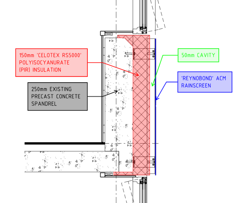

Summary of what a perimeter section 'make-up' looks like (excluding the upper and lower details of how the cladding integrates into the window framing):

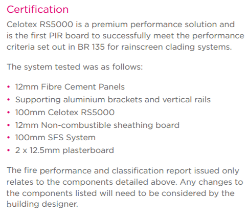

From the Celotex website, the datasheet on the RS5000 product Link (which is specifically designed for 'rainscreen' cladding applications), states:
"100mm SFS" is cold-formed steel framing.
The fire performance system testing appears to be done on a 12mm fiber cement panel cladding system.
No mention of the ACM panels in any fire performance system testing.
Agree, news indicates the masonry brick here is 250mm thick, and the air gap is 50mm - these will make the case for justifying the insulation even more difficult. Am not a fire expert by any means, but personally, I would baulk at the thought of using this awful isocyanurate foam material as insulation for any application, even if it were to be sandwiched in between 2 brick layers (unless you tell me the insulation cavity is completely airtight for 50years, even in fire conditions ) - the thick black billowing smoke we see in the video clips and photos tells me this could have only been from some cheap insulation. Should have been mineral wool or rock wool if you really need safe thermal insulation.

Other point is that unlike the drawing, the reality if you look at the photo from epoxybot is that the windows are designed to tilt inwards at the top or open inwards. Both designed to stop things accidentally falling out of the window from an internal sill, but if left on vent by tilting inside will have fed flames and smoke into the flats very quickly, probably burning curtains etc.

The gap between the hard foam and the weather protection apparently prevents dampness penetrating the insulation but then causes issues with the flame speeding up behind the weather facing.

I have no knowledge of the UK Building Codes but I can assure you the design schematic you posted appears to have deviated from the ICC Evaluation Service report for the Reynobond ACM Rainscreen. See Section 4.4 of ICC ESR-345: This installation, in the US, would violate 2012 International Building Code Section 1407.
