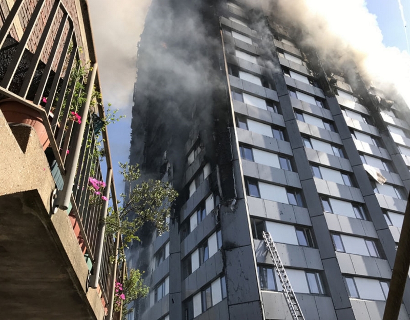

A report I heard explained that the material in the aluminium cladding was not so much an issue as the design. The space between the cladding and the outer wall acted as a near-continuous chimney, allowing heat and flames the rise up the building sides very rapidly.
bbc.co.uk and theguardian.com will have up-to-date information.
"If you don't have time to do the job right the first time, when are you going to find time to repair it?"
brimstoner... and the insulation was combustible, too and the aluminum was a replacement for metal with a zinc coating... The replacement was undertaken for energy savings... with the several million dollars (euros, pounds, or whatever) it would have taken centuries for 'pay back' (unless you live in Ontario, where the return period could be a couple of weeks)... [Change]The Architects replaced a safe, non-combustible cladding with an unsafe system that may have cost 100 people their lives.
There are likely 'stack' issues that brought the fire and heat to the interior of the structure... I'm not sure sprinklers would have helped, but, they wouldn't hurt. The single stairwell was not good.

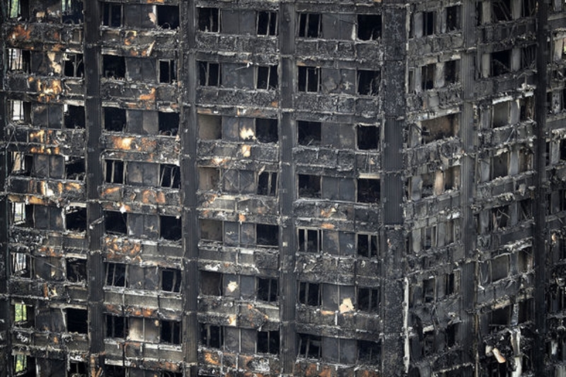

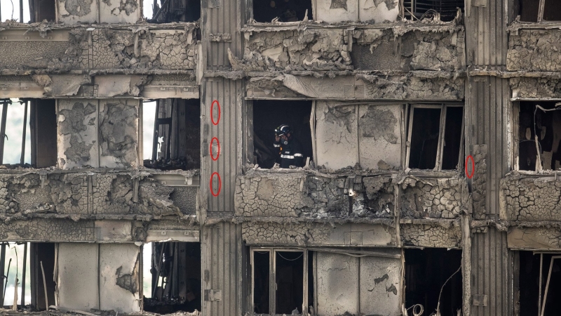

I will be curious to see what an investigation of the supply chain reveals. Photos after the fire show much of the spandrel panel insulation charred but still in place. The Columns are mostly bare. Consider that the spandrel panels were a custom profile, while the columns have more of a boilerplate fabrication. Did the manufacturer sub out the production of the column profiles or is the production line for the more standardized shaped cladding manned by less experience personnel? This photo sticks me as important in understanding what happened. It is when the sky is still in a state of darkness. Here are some time references.

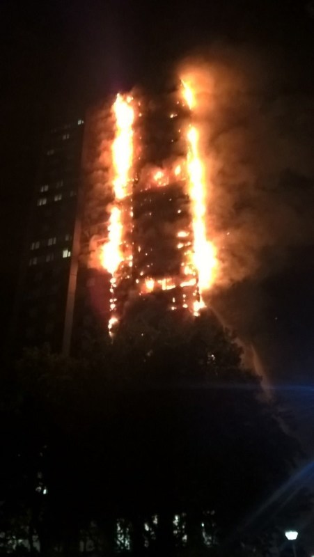

epoxybot... it took 4-1/2 minutes for the flame to travel full height apparently.
Dik
Good observation, epoxybot. There was nothing to stop/start the fire going up the columns. But I doubt the details of fabrication made much difference.
Well something appears to have changed from the drawing board to the time of installing the cladding. It appears the number of/or location points of the column cladding changed. The susceptibility to fire damage between the column cladding and the spandrel cladding also seems dramatically different. In one photo of falling/burning debris there appears to be a plastic film as a remnant of a panel.

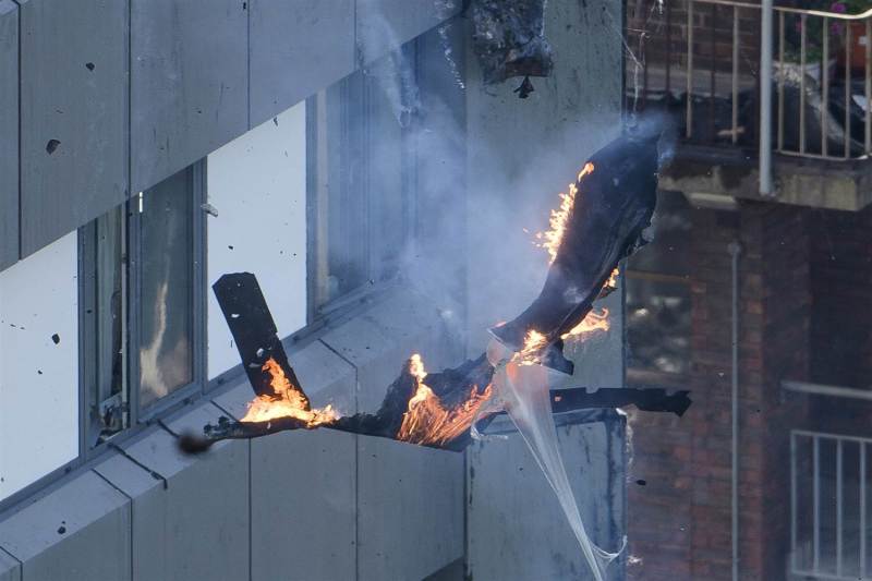

The plastic film was created by molten plastic that resolidified as it was falling through air. In videos of the fire you could clearly see burning molten plastic pouring from the facade, and also strings and sheets of resolidified plastic floating in the wind.
What part do you think was plastic? Could that not be aluminum?

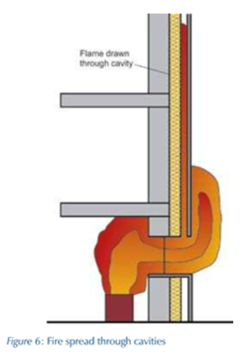

PROBYN MIERS said:
3.3 Interaction with the external envelope
It is at this stage of the fire scenario that the fire performance of the complete external cladding system, including any fire barriers, is critically important. Once flames begin to impinge upon the external fabric of the building, from either an internal or an external source, there is the potential for the external cladding system to become involved, and to contribute to the external fire spread up the building by the following routes.
3.3.1 Surface propagation
The reaction to fire characteristics of the materials used within the external cladding system will influence the rate of fire spread up the building envelope by way of the surface of the external cladding system.
3.3.2 Cavities
Cavities may be incorporated within an external cladding system, or may be formed by the delamination or differential movement of the system in a fire. If flames become confined or restricted by entering cavities within the external cladding system, they will become elongated as they seek oxygen and fuel to support the combustion process. This process can lead to flame extension of five to ten times that of the original flame lengths, regardless of the materials used to line the cavities. This may enable fire to spread rapidly, unseen, through the external cladding system, if appropriate fire barriers have not been provided (Figure 6).

Compositepro and Hokie: I would have thought the heat was sufficient that the aluminum panels would have melted/burned and with convection may have appeared to be 'floating'.
