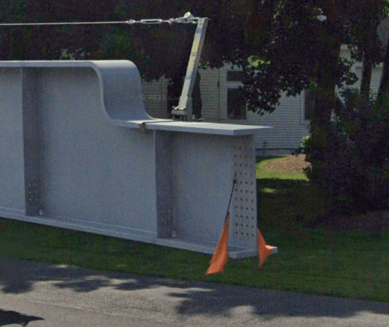

From the images, as compared to the old bridge, the beefed-up section of the new bridge appears to have NOT been long enough to fully span the unsupported portion of the overpass. Tug might have been right in the sense that the span was not perpendicular to road that it was crossing, meaning that either the beefed-up section had to be longer than necessary if the bridge layout was symmetrical or if they were only as long as needed, they needed to be staggered so that they both fully spanned the overpass.
John R. Baker, P.E. (ret)
Irvine, CA
Siemens PLM:

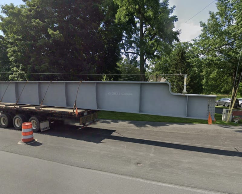

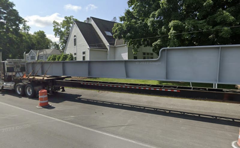

DanKile's Google image shows the beam to be asymmetrical, with (apparently) a bolted joint at one end. One of the Times-Union pics seem to show a bolted splice. Maybe for transport?
Appears to be for transport. One end is longer. The longer end is the one that buckled most, due to longer lever arm available to crush the web.

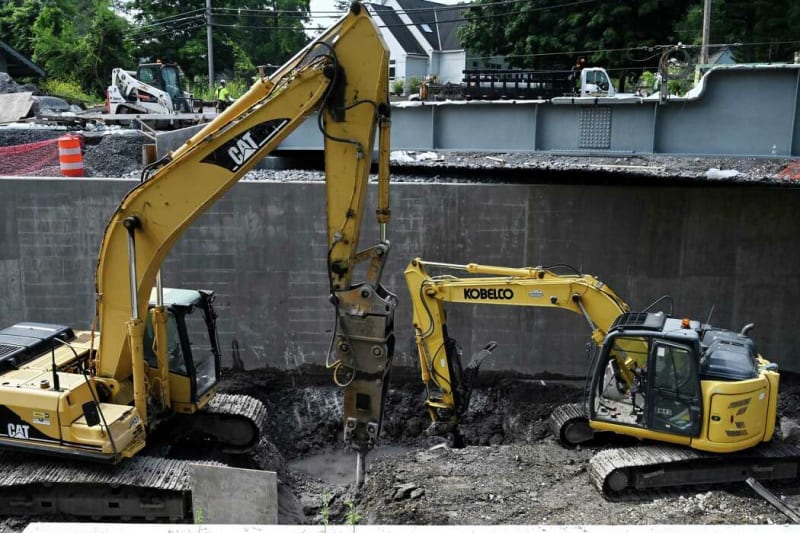

The original deep section span did not reach - that's why there were supports at the ends of the original deep section of the span. They took out the supports to make the road wider and to shift the sidewalks underneath. then decided to put the weight of the road paving machine and so forth on it.
So - the old span was hit 9 times in the past 11 years, including by a cement truck and won that battle. Someone was smart enough to realize one could not move the sidewalk with the old bridge supports and so duplicated the solution that required the old supports but didn't use them.
I think of Red's opinion from "The 70s Show" - Dumbass.
It's pretty close to my favorite failure mode - the can opener, with the shallow section top plate acting as the opener for the more vertical section of the transition. Nice job putting inadequate radii to make that action less abrupt and extra points for buckling the web.
Can opener 😂, that’s pretty much it.
More than likely the design - as seemingly bizarre as it is until you realize they were trying to match the general look of the old bridge - would have been more than satisfactory if they'd just thrown in an extra stiffener at the transition. A nice 45 degree stiffener likely would have prevented the buckling and allowed it to carry the loads nicely. That's something a senior engineer should have looked at during a design review and said "hmm...something's off here..."
When I do these I just extend the flange a long way into the new section.
Also a good solution. That's my go-to when I'm making a 'seat' connection at the end of a beam.
I would have expected an extension of the flange of the shorter section to push into the web of the taller section at a length equal to the difference between the flange heights (a la AISC SCM 15th ed. Figure 9-11.b).
But then you lose that nice, continuous curve of the top flange. We can't have that, now can we?
