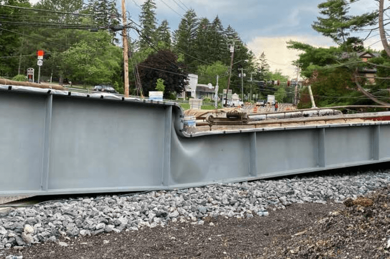

I think they forgot some stiffeners [sad]

A question for the structural guys;
Could the one buckled panel be replaced with a panel that is thick enough to carry the load?
If so, that would be the quickest, and cheapest fix.

Stupid design. Top element from thin section should continue at least into next panel or two of the taller section.

The bridge designer did the same thing and put stiffeners right NEXT to the step down in section depth. Do you guys think the stiffeners immediately adjacent to the step down helped promote buckling at that section, or the buckling strength at that section is equal to or greater than if there were no stiffeners at all?

The compression forces will not stay in the upper flange S bend. It would be quite difficult to design reinforcement that would work here.
The top flange on the lower step presses horizontally into the taller web element. This would require radiating elements to distribute the force, primarily to the top flange of the deeper center beam section.

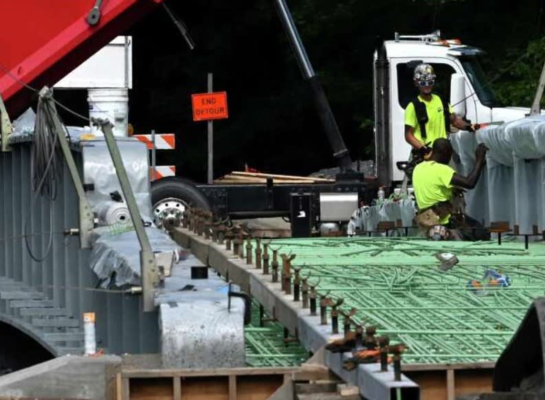

Looking at the photo before concrete was poured, this is a pretty impressive amount of re-bar.
The bridge is also slightly curved. Was the intent for the concrete to essentially be the main supporting structure and the side bits decoration?
So during construction it would need the bridge temporarily supported? Which didn't happen on the side which bent? won't be the first time that loads and stresses during construction don't get looked at properly.
It's interesting that on the other side there are some steel supports between the bridge and the abutment / retaining wall.
A fabrication error could be contributing to the failure. The rendering and elevation show a stiffener ~4" from both depth changes. What was fab'ed is different, maybe ~8" at one end and ~3' at the other.
I'd like to know which structural analysis methods/tools they used since this structure was never going to work.
