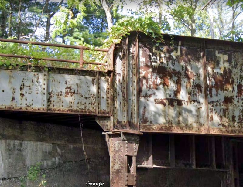

Are we missing the bleeding obvious here? Was there supposed to be a support, either temporary during concrete work or permanent?
What are the three odd looking things on top of the new wall?
But if not I stick to my premise that someone found the old drawings of the bridge and said to a fabricator, give me something that looks the same as its a replacement. Someone else then decided to dig the underpass deeper and not put the retaining walls / supports back in. But no one told the fabricator....
I don't understand how someone took a 3 span bridge, replaced it with a single span, and never thought that the longer (approx 3 times) span might just possibly require different beam design.
The old one is very clearly three separate structures joined together and totally reliant on the support for vertical load.
I take back my comment about them being the same, but still think someone forgot to tell the designers the supports wouldn't be there...

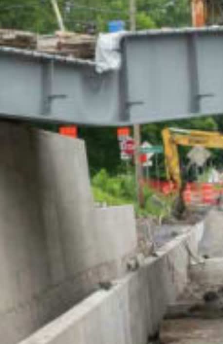

There were what appeared to be temporary supports for the span; you can see that the buckled section had such a support in the first picture I posted.

Your picture is the other side and it looks like a proper sypport to me.
So I think they were missing sorts on the other side which collapsed
The "other side" with the blocks underneath already experienced buckling of the web; probably why someone made an impromptu support.
Other photos / Google maps street view show proper bridge rocker plates at the ends of the bridge and no other intermediate supports.

I suspect the majority of the steel can be saved if they cut the top plates off the shallow sections and either extend the deep section or meet the deep section with a taper and fill in the web to match. They can use the majority of the cap from the shallow section. When they are doing that they can cut out the buckled web and jack the rest back up, not in that order. It won't look so good as the factory finish, but with so much of the roadbed in place putting the beams back on the truck or dropping in new ones is off the table. At least the foundations for the supports are likely to remain in place.
