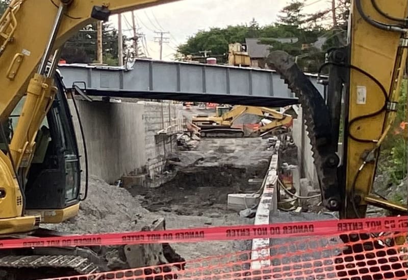

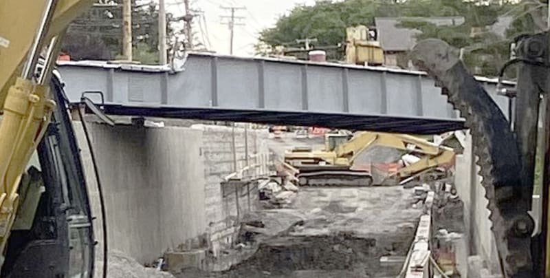

Looks like it is coming down:
On Thursday, the county said the bridge would be "shored up" by the end of the week, and next week the damaged steel will be removed. Contractors will then move on to drainage, paving and sidewalk work along Route 85. By the end of August, eastbound traffic on Route 85 will reopen from 6 to 10 a.m., the county said.
"The concrete, when set, would have acted above the bottom flange at an elevation above the thickness of the cross members and somewhere internal to the thickness of the concrete slab."
I think it would have done that when it hadn't set, also. Which kinda looks like what happened to take the bridge down.
I'm having trouble envisioning that load path.
"Given the relative incompressibility of concrete, the slab (when set) would have provided a lot of stiffening."
Would that stiffening have held up the bridge? How?
