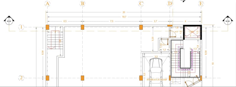

Further to the question "What kind of support?", following is a partial Ground Floor Plan. There are 24 risers on one stair and 14 on the other, but the floor to floor height is the same. If the left hand stair expands to the north (down on plan), I would expect to see an additional column in the parking levels to support the stair above Ground Floor. It should fit between cars so that the two cars blocking the drive aisle can be moved to Grid Line A.

My intent is to use some concrete walls at the upper floors? So my query about supporting upper floor walls at lower floors. Can upper floor walls be supported by columns at lower floors? Or maybe other options are available?
Yes indeed! Not a problem. As for other options, a wall could be used, running east/west and placed between the two cars which project into the aisles in the parking levels. There appears to be ample room between those cars, so the wall could be any thickness required (within reason).
The typical floor to floor height is 3.6m for all floors except Ground Floor which is 4.6m. It is not clear why the typical floor headroom has to be so high. Usually, in residential buildings, the floor to floor height is much less.
The number of risers shown on the drawings is not consistent, with five more risers on the right stair than the left, ten more for the Ground Floor.
Before the Ground Floor Framing can be completed, the left stair has to be enlarged to accommodate more steps. Reducing headroom where possible represents a saving in cost.
I am still wondering why the municipality requires 20% of the building area to be "open". That has not been explained to date and is not standard practice anywhere so far as I know. I consider it a total waste of space, space which could be better used for occupancy.
to me the logical place for the lift would be between B and C perpendicular to the road. then arrange parking so one turn only into spot, or something like.
Ideally you'd drive onto the lift from the road and then park, but be able to flip the car so you could drive straight onto the road ... but here you'll have to reverse onto the lift and then reverse out into traffic ...
Can you (as a parking manoeuvre) reverse over the lift ? is the lift flush with the floor, no edge or sides (that sounds scary) ?
But I still see no way you'll get the seven (or eight ?) spots "required". Try it out, full sized.
