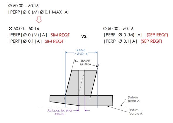

I wasn't thinking about it this way. The picture below should help to clarify my point. My apologies that it shows external FOS rather than internal FOS as in Fig. 6-15.
For the part as shown:
- When both callouts are separate requirements, the measured perpendicularity value for the RFS callout could first be reported as 0.1, and then the part would be tilted to make the size of the RAME conforming (equal to or less than 50.16);
- When both callouts are simultaneous requirements, they have to be considered in a single datum-to-datum feature relationship, therefore for a conforming size of the RAME, the measured perpendicularity value for the RFS callout will always be less than 0.1.

See my response (15 Aug 19 16:12). Could you explain why you believe the single FCF in 6-15 is an example of simultaneous requirements, considering that concept does not apply to perpendicularity (and it is shown as a single callout, not two separate)? And additionally why you think it might be a valid callout despite the fact that it is a single MMC control for which the surface interpretation must take precedence?

This wasn't to provide a definition of simultaneous requirements, so let me try from another angle by using the following - maybe not too realistic - example:
An inspector is told to evaluate the conformance of the feature from my illustration to the MMC MAX callout with the use of axis interpretation. For the shown orientation of the part relative to the datum plane A, the measured axis perpendicularity value is 0.1. Technically, this is all that is required from inspection point of view because feature axis is conforming to the specification. But the inspector is educated enough to know that in case of extreme orientation error values, as shown in Fig. 5-2 in Y14.5.1M-1994, the virtual condition boundary (dia. 50.16) might be violated by the surface of the feature, therefore he decides to perform additional RAME size check. Since the check is giving a value greater than dia. 50.16, he is taking the advantage of the candidate datum concept by trying to tilt the part to see if the size of the RAME could be adjusted to dia. 50.16 or perhaps smaller. Once he has done it (assuming he was able to), he is now going to re-measure and report the axis perpendicularity value.
What I am trying to say here is that he will not report the initial value of 0.1, but the re-measured smaller value, and that the measurements he performed are equivalent to the check against the duo with SIM REQTs.

Can you describe a part that would be rejected by the ASME Y14.5-2009 Fig. 6-15 scheme, but accepted by the scheme I described?
I still haven't succeeded in imagining a part that is rejected by one scheme and accepted by the other. It seems plausible that such a part exists, but if not, then the two schemes must be equivalent. I'll try to give it some more thought.
