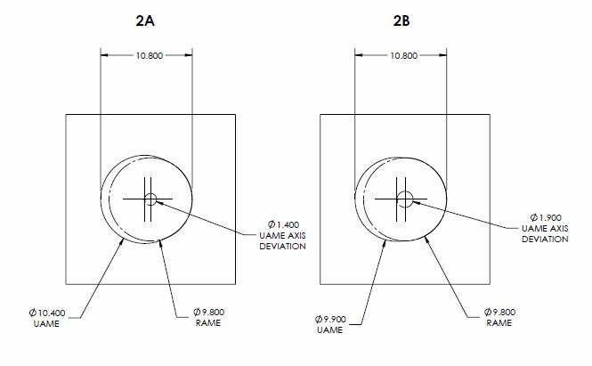

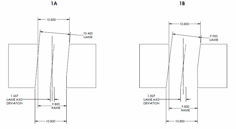

ASME Y14.5.1M-1994 surface interpretation actual values for RFS position are as follows:
internal feature: actual_value = size_UAME - size_RAME
external feature: actual_value = size_RAME - size_UAME​
The reasoning is simple: If there is no location, orientation or form deviation, size_UAME = size_RAME, so the feature utilizes zero tolerance, in other words, the deviation from true position/perfect orientation is zero.
In the context RFS tolerances, it makes sense to say that a feature has perfect location when its UAME axis is coincident with true position. A tolerance zone size of zero is sufficient to contain it, and it's not possible to get any better than that. Perhaps more importantly, it's not possible to satisfy the tolerance by a larger margin.
I don't think it makes sense to consider MMC tolerances in terms of deviation from perfection. The location of the UAME axis is irrelevant because it doesn't tell you anything about whether the feature surface violates the virtual condition boundary. It's always possible to satisfy the tolerance by a larger margin (until the feature disappears) so it seems hard to justify calling any particular condition "best" or "perfect".
Example:
Specified hole diameter 10+-0.2
Perpendicularity requirement with reference to datum feature A: 0.1 at MMC.
Produced UAME size: 10.1
Produced RAME: 9.85.
First, what should the actual value be compared to? Everyone learns early at any GD&T training that departure of feature size from MMC gives additional tolerance that can be added to the specified tolerance value, to calculate the total allowed tolerance.
For this case departure from MMC is 10.1-9.8=0.3, so there is up to 0.1+0.3=0.4 orientation tolerance that can be utilized.
How much of it is used by the surface deviation of the feature from a boundary which is equal to its size and oriented perfectly? That is the "actual value" as I would prefer it to be defined: 10.1 (UAME dia.) - 9.85 (RAME dia.) = 0.25.
That is less than the allowed 0.4 for this UAME size, so the hole conforms to the specifications.
You might also say that the hole conforms to the perpendicularity requirement by a margin of 0.15, calculated as 0.1 + (10.1 - 9.8) - (10.1 - 9.85). That same result can be calculated as 0.1 - (9.8 - 9.85) though, and the latter method avoids involving the UAME size. I think this elimination of an extraneous factor is advantageous just for the sake of simplicity, but it also allows the method to be applied when less information is available.

Lets take your current definition of the tolerance zone (note this is the same as the MMC axis interpretation) which you have called the "total allowed tolerance"
total_allowed_tolerance = t0 + (size_UAME - size_MMC)
and your definition of the actual value (note this is the same as the RFS surface interpretation)
If I follow your logic, essentially the feature is accepted if:
actual_value ≤ total_allowed_tolerance
Lets substitute in the previous equations
size_UAME - size_RAME ≤ t0 + size_UAME - size_MMC
size_UAME cancels out on either side, and rearranging we get
size_RAME ≥ size_MMC - t0
This is the definition of the surface interpretation for MMC per Y14.5.1 table 5-2 and can be solved for the actual value as we've already shown. The extra step of essentially adding size_UAME to both sides of the equation gets the same result and is not necessary.

I think it's important to recognize that UAME size can be measured without gaining any information about axis orientation or location. Similarly, axis orientation or location can be measured without gaining any information about UAME size, although this may be less common.
I guess thats some unfortunate wording on my part. I just meant that by establishing the UAME boundary the UAME axis is also established whether or not its position/orientation is measured (though I guess one could argue semantics or philosophically whether its actually established if we never measure it), and in order to establish the UAME axis the UAME boundary must first be established whether or not its size is measured. Perhaps this is an obvious conclusion, and your point is well taken.
I'm glad you agree with the rest of that post - its good to know I'm on the right track as I hold your opinion in very high regard, it took me a little bit to realize the proposed scheme is in fact not fundamentally different but basically just a restatement of the current MMC surface interpretation with extra steps.
The whole notion of "additional tolerance for departure from MMC" is only used for the axis interpretation. A lot of potential confusion can be avoided by recognizing that this is only an approximation to the definition which takes precedence.
Seems like we're still mostly on the same wavelength I think (also within 5 minutes...!) and this is the concept that seems to be a major sticking point which I also tried to address in my post from a similar angle. Trying to make the surface interpretation provide a result which approximates the "additional tolerance" concept found in the axis interpretation does not seem to me a worthwhile exercise.
I claim that it's better for actual feature size to remain uninvolved in the actual value calculation. If anything, "accounting for size" sounds more applicable to your suggested method of actual value calculation.
An MMC position tolerance does place an inherent limit on the size of the feature, but that's an unavoidable consequence of the meaning of the tolerance. It has nothing to do with actual value calculation.
Excellent point - I skirted around this when I said 'the current definition "accounts" for size insofar as it does not attempt to remove its effects' but this may be somewhat shaky and inviting misinterpretation, although maybe you get what I mean? I think it may be more proper to say size is not involved in the actual value calculation for the surface interpretation since in reality size (per the swept spheres or the approximation afforded by the UAME) does not appear in the equation.

If we take a look at the cases below, when form error is introduced comparison of the UAME and RAME provides no relevant information as well as doesn't match the axis interpretation actual value (as we know). In reality this definition of actual value (size_UAME - size_RAME) has little use when considered by itself, and is only really useful in comparison with your "total allowed tolerance" (t0 + size_UAME - size_MMC). I already showed that when compared, the size_UAME term cancels out and is not necessary.
In both the below, lets take the theoretical specification of:
dia. 10 +0.8/-0.2
|POS|dia. 0(M)|A|B|C|
1)
Y14.5.1 surface interpretation (both) actual_value = size_MMC - size_RAME = 9.8 - 9.8 = 0
Your surface interpretation proposal (1A) actual_value = size_UAME - size_RAME = 10.4 - 9.8 = 0.6
Your surface interpretation proposal (1A) total_allowed_tolerance = t0 + (size_UAME - size_MMC) = 0 + 10.4 - 9.8 = 0.6
Your surface interpretation proposal (1B) actual_value = size_UAME - size_RAME = 9.9 - 9.8 = 0.1
Your surface interpretation proposal (1B) total_allowed_tolerance = t0 + (size_UAME - size_MMC) = 0 + 9.9 - 9.8 = 0.1
Y14.5.1 axis interpretation (1A) actual_value = D/2 = 1.357/2 = 0.6785
Y14.5.1 axis interpretation (1A) tolerance_zone = 0.6*
Y14.5.1 axis interpretation (1B) actual_value = D/2 = 1.827/2 = 0.9135
Y14.5.1 axis interpretation (1B) tolerance_zone = 0.1*
As you can see from the features shown by 1A and 1B, neither is any closer/further from violating virtual condition however both your proposal and the axis interpretation produce wildly different results. This is why the comparison of the UAME and RAME is only useful in cases of perfect form. What do the values of 0.6 and 0.1 tell us? It does not agree with the axis interpretation due to the form error. In fact, the latter which should be "more perfect" in your definition (size_UAME nearing size_RAME) actually results in a UAME which is even further from being coincident to the RAME (shown by the axis interpretation actual_values of 0.6785 and 0.9135).
Your proposal for actual value is only useful when compared to the "total allowed tolerance" (0.6-0.6=0 or 0.1-0.1=0) because, as I showed earlier, the size_UAME term cancels out and you are left with the current definition of MMC surface interpretation.
*same as your "total_allowed_tolerance"
2) Same calculations as case (1) except for the below
Y14.5.1 axis interpretation (2A) actual_value = D/2 = 1.4/2 = 0.7
Y14.5.1 axis interpretation (2B) actual_value = D/2 = 1.9/2 = 0.95
A similar case as (1) however with a UAME axis parallel to the RAME. As you can see, the UAME can be located as far from the RAME as the limits of size will allow and the relative size of the UAME and RAME tells us just as little as it does in case (1).
