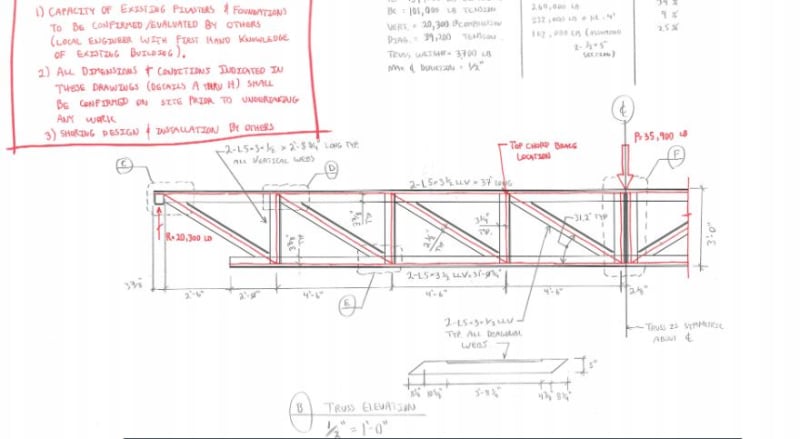

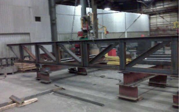

I've got a horror story for y'all.
Back in 2008, my best childhood friend told me that his dojo (ninja stuff) wanted to remove some columns from their training area. Kids were accidentally kicking teleposts and such. He had a bunch of scrap steel angles and asked if I'd design a truss for him to facilitate the removal of the columns.
My friend was a very experienced structural welder recently released from prison for non-violent crimes. The martial arts teaching thing was kind of his path back to the light after a fashion. It meant a lot to him and was one of his only viable options for employment at the time. In his age bracket, he's actually one of the top martial artists in western Canada.
So yeah, some red flags there. The conversation went like this:
KootK: NO WAY can I stamp this thing.
Friend: Don't worry about it. The dojo owner owns the building and doesn't need a stamp.
KootK: Still, there's a lot to consider here. It's not just the truss but, also the existing masonry piers that it sits on, the footings, blah blay.
Friend: Look, just tell me the truss depth and web configuration to make the thing work. The angles are what they are and I'm just going to weld the snot out of everything anyhow.
KootK: No, still to dangerous for me, and the public.
Friend: You know full well that I'm doing this with or without your help. If you help, the little ninjas will be safer than if you don't, right?
KootK: fine, but my name can't be on anything and I'm limiting my scope to just the truss.
In the end, I realized that if I was in for a penny I had to be in for a pound. So I wound up designing the entire system. My friend was so proud of the work that he went and posted pictures of it on Facebook and tagged the truss "KootK" as if the truss were actually me.
How's that for discretion / no deed going unpunished? The red box below is full of CYA disclaimers that surely offered me no real protection at all.
