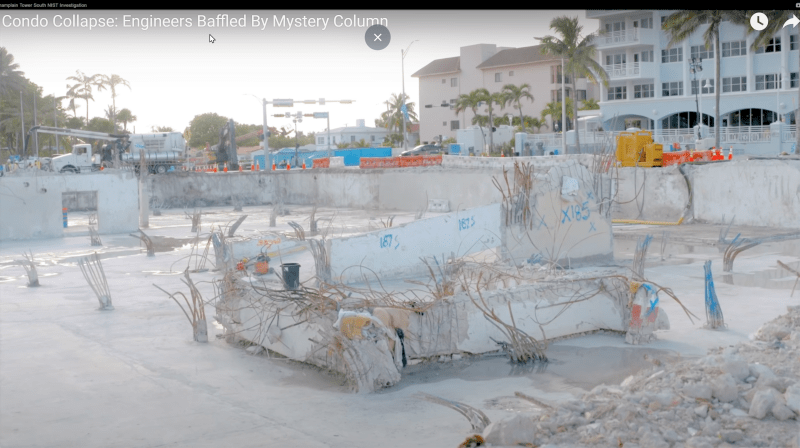

So far the only reasoning I can come up with that sidesteps all of the logistical obstacles and other reasoning, is that this column was added sometime after Fiorella's garage video was shot in July 2020 and before the collapse date.
And that this new column would not have been used to shore up the H beam because it is too far from the age beam to be directly underneath it.
But rather this column would have been placed to shore up some part of the lobby floor slab right near the H beam.

An 18"x24" at minimum column popping up in the middle of a drive lane with no one noticing or complaining. I just can't see it.
They could put this column there in the middle of the drive lane until people look just drive around it for the time being until we can get the ceiling fixed.
As far as where the drone video came from I can't discuss that. There are still certain legalities about flying drones in certain areas we will just leave it at that
I missed the opening. I only saw the NIST B-roll. If it is who I think it is that's still flying his drone, it's only a matter of time until more than just the local cops pop up at his door demanding he stop.
If they were to build an 18"x24" or 24"x24" column there as temporary shoring, that'd leave them with 9ft on either side for travel lanes. Not an impossible drive, but still, why and who would have authorized it?
Edit: Also, why here, but not under the other noted failed/failing slab sections? Specifically around the K13.1 region.
At Champlain Towers East, they have a lot of shoring in the garage right around columns to support the weekend lobby floor.
Can't see any rebar under the red column. Maybe the red column ripped off the blue rebar next to it and it's actually one column at the location of the rebar.
Edit: If you zoom in you can see that is the top piece of the red column. The corners are rounded and rebar ears sticking out of it. Either it fell off during the collapse or someone sliced it off and placed it there.

I don't doubt rebar punching into the slab at all. My only issue is the size of the cage. A K column is 12"x24". The red base column, if in correct location, would be a column F 16"x16", to the right of that a column L 12"x24", and at the south end of beam 35, a column C 16"x16". There's also a 36" safety cone with a 15.25"x15.25" base near for comparison too.
For that to be a K, it would have had to have fallen towards the ocean 4'5" or so. Did that fall towards the ocean while everything else fell away? Potentially a C(O10), L(P8), or D(O6) column instead? I feel one of these hitting on a diagonal could at least leave a similar pattern of rebar in the slab. I've seen some other C columns blown open similarly.

So your main question is which column punched into the slab based on the size of that group of rebar. While all the columns you mentioned are possible candidates, the K seems to be the closest to the point of impact. After it broke free of the H beams, those beams could have deflected it's direction of fall or the buildings rotation just before it fell may have steered it to that point. Many of the other columns broke at each floor but remained joined by the rebar giving them a linked sausage appearance and for one to break off cleanly enough to punch into the floor seems much less likely. Also the K column's 24 inch dimension was oriented in the north-south direction but some of the rebar may not have remained stuck in the floor after the cleanup.
I'm still pretty open to it being some other column if better evidence emerges.

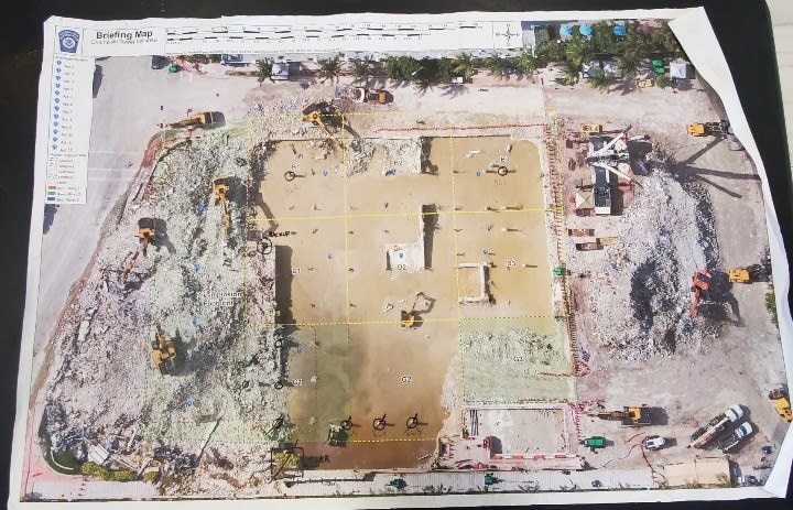

Briefing map from July shows the H beams in the same location that they are in now, and also shows the "mystery" column. So it appears to not have moved much when it fell, or to have been moved.

Regarding the mystery rebar, could the remnants of the supported column have still been attached to the top of the vertical section and perhaps they cut it off and just set it adjacent to the structure? Because the base of that rebar is very dark and black looking compared to all other column bases?
The base is darker there due to it being wet.
For higher res, 1:50 time stamp in the NIST video.

I just don't see how they built an extra column after 2020 and kept it a secret. Every person who went into the garage would have seen it. There'd be a long digital paper trail.. plans, permits, certifications, cost estimates, bills ect...
Well we know that they had applied for parking relocation permits to begin the shoring up of the garage. Maybe the shoring up was already in progress in certain areas of the garage, and using the typical metal braces were not going to be strong enough to hold up that H beam, so they had started placing a new column there?
Maybe someone can clear up the mystery by examining the markings on the left-behind rebar.
Not to mention no Engineer anywhere in the world would put a column in the middle of a driveway only 4.5 feet from a perfectly good K column and transfer beams but supporting nothing, and only supported by a slab with no pilings at all underneath it.
