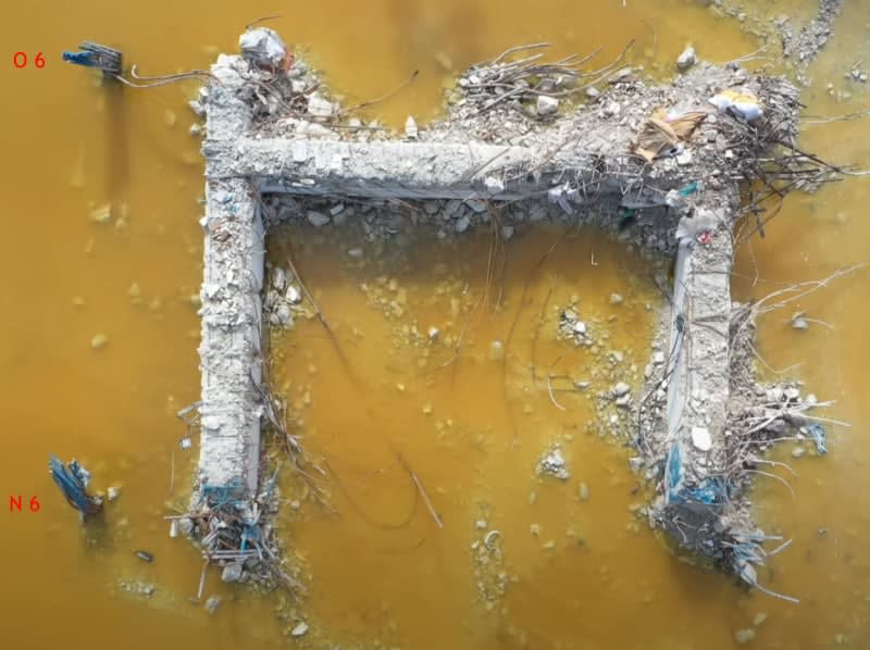

That "H" is resting quite north of where it is in the drawing, unless I'm stupid.

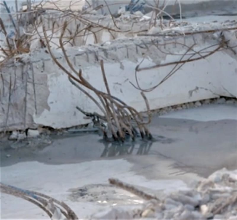

Whenever someone makes the claim like this about the column falling eight feet and impaling into the garage floor, you forget that there is zero damage on the floor where there should have been craters or something else if it had impaled into the floor but there is no damage. These rebar rods look like they were intentionally built up out of that concrete floor like it was done by somebody in the last 12 months, since Fiorella shot her video inside the garage in July 2020, showing no column exists where that mystery column is.
Jeff Ostroff said:
These rebar rods look like they were intentionally built up out of that concrete floor like it was done by somebody in the last 12 months...
Who would build a column where there is no pile to support it?
What could they have been trying to support with that column?
IF...they were to build this column sometime between Fiorella's video in July 2020, and the time of the collapse, the only reason I can think of is they were adding a temporary shoring of the lobby level floor right near the beam, or possibly they saw something wrong with the H-beam like deflection, and maybe the bottom of the H-beam was under tension so they would build a column to support the bottom of the middle of the beam as a shoring.
Now, what if someone built this column without pulling permits? There might not always be a paper trail, and Surfside is missing documents.
Why would the column be built without a pile under it? People are stupid. Maybe it was temporary to help distribute part of loads from above.

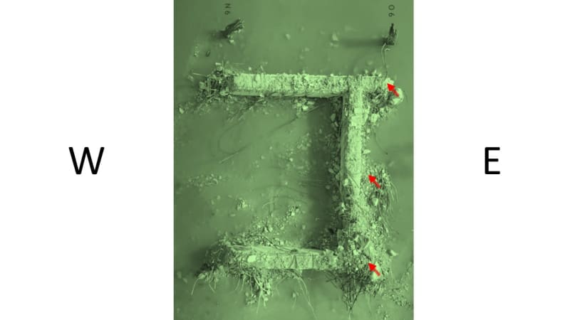

Yes, (Well, a few feet Northwest, I think. see Auri's photo from 15 Jul 21 00:30 in Pt 6, reposted by Demented (Industrial)7 Nov 21 18:07 above) ... and the "H" has dropped several feet from the garage ceiling to the slab. It has debris under it. The columns it was supported by, are still vertical. It must have moved off the columns to get to the floor.
SF Charlie
Eng-Tips.com Forum Policies
Yes, it appears the H-beam moved 12" to the north off the columns to slide down to the floor. And still does not explain the mystery column, centered about 2 feet east of the H-Beam coming out of the garage floor.

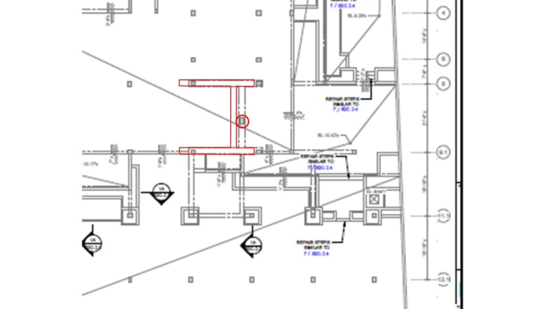

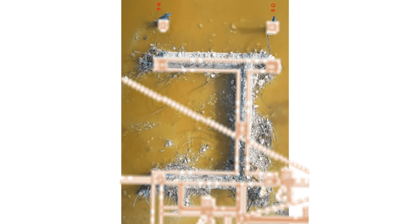

Well. I don't know. I think I'm seeing what Autistic was referring to. I'm talking more like 15-20 ft. whatever the column spacing is to the north (a row of columns). The H appears to lie in line with the bottom of the ramp which is not where it is in the drawings. As Autistic said: "very far away from its original location".
I think a lot of you are misreading the floorplan, especially if you use the drawings SFCharlie submitted above.
The line that you think is the bottom of the ramp on that drawing is NOT the bottom of the ramp!
The drawing shows the ramp in abbreviation mode, meaning it is not showing you the ramp continuing to the end, the bottom of the ramp really extends down to be in line with the north side of the H-Beam.
The H-Beam did not move. You misinterpreted where the bottom of the garage ramp is. Remember, SFCharlies posted floorplan above is not a garage level, it is a ground-level drawing, so it only shows the ramp going down halfway, not all the way. Just like architects renditions of stairs don't show them going all the way down to the bottom.

Most of the plans don't show that the ramp extended a full parking space beyond the stairwell, that has thrown me off a few times too.
Got it. Thanks. I will re-calibrate.
Exactly @optical98, I tell everyone to look at the part of Fiorella's video that I showed in this video, and you'll see it shows the ramp extended beyond the stairs to become space #14, and I also showed you on her screenshot of the garage that the H-Beam is inline with the bottom of the ramp.

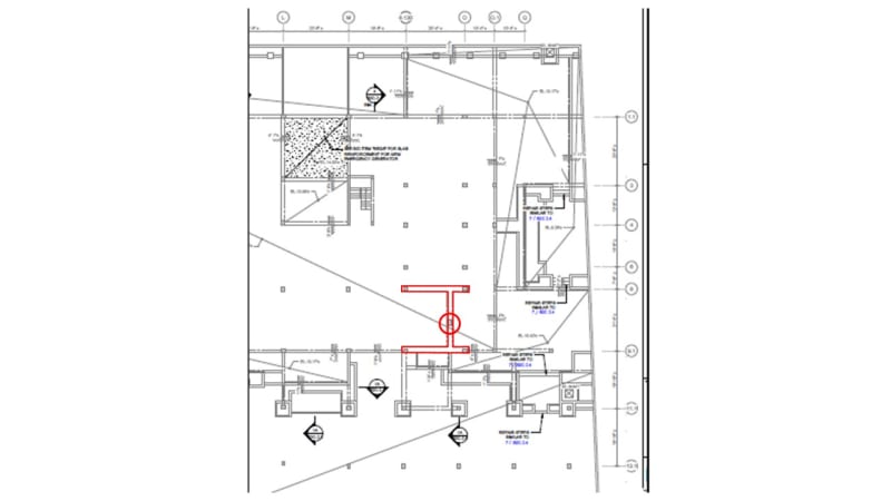

Ok Ok Finally, Dawn breaks over Marble Head. So, my ghost column is on the first floor plan. So now I'm trying to understand, was it attached to the top of the "H" beams? If so, where did it go? Shouldn't there be some rebar on the top of the "H" where it was attached? Now I'm sure I'm more confused than ever.
Sorry everyone. Thanks for straightening me out.

edit: just thought a little closer look at the rebar sticking out might help. Not so sure that the dark color is just because it's wet.
Okay, I was wrong previously. Look, it's really up to you Jeff to find a permit somewhere in which someone drilled a massive hole into the foundation and installed a magical column sticking up in the middle of the lane. I don't think anyone is putting a column up in the middle there. Is there even a PIF foot underneath that?
Look, it's really very simple, you have a column in the middle of the H beam, and the only thing holding it up is the H beam, and the H beam has dropped down the foundation. So, the column is going to drop as well. Perhaps the column punched through the foundation? I can't find any other logical conclusion. Does anyone here disagree with the concept of a column shearing through the foundation?
Really, this topic is pretty dead. What is the mystery? The column PIF'ed it's way through the foundation. It's not like the foundation is going to be super strong in the middle.
