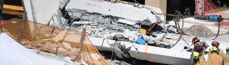

I am curious as to what led to the (apparently) field-enlarged pocket for 11’s top tendon anchorages. Suggests to me that they were unable to get to the tendons for releasing the PT force, or??
Tendons too short seems highly unlikely to me. But why the need to expand the pocket?

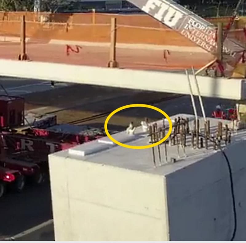

UKJim - in the photos taken during bridge placement, the same ragged edges are visible in the blisters. Whatever happened to them happened before the bridge was on the pylons. My guess is that rather than making a nice trough for the concrete pour they used spray foam or some other material to maintain access.

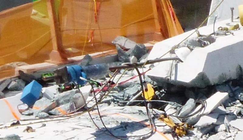

"This confuse me. For my untrained eye looks like a PT bar but from where to where ?"
I believe that it is tendon duct or utility duct from the canopy but could be wrong.
Thanks. I see that now in one of the night photos. Still seems an odd thing in such a highly designed structure.
appster said:
Meerkat 007
Looks like 11’s upper tendon to me.
Nope. That’s not it. Maybe an empty duct left from where 11’s lower tendon ripped through? Tough to say.
UKJIm
I was referring to the white snake going almost full length of the blister. Can only hope that the NTSB keeps a few larger pieces such as what is left of this cap and what is left of 11 and 12 to examine more closely.
UKJIm
Yup. Sorry. I see that now. Hard to tell.

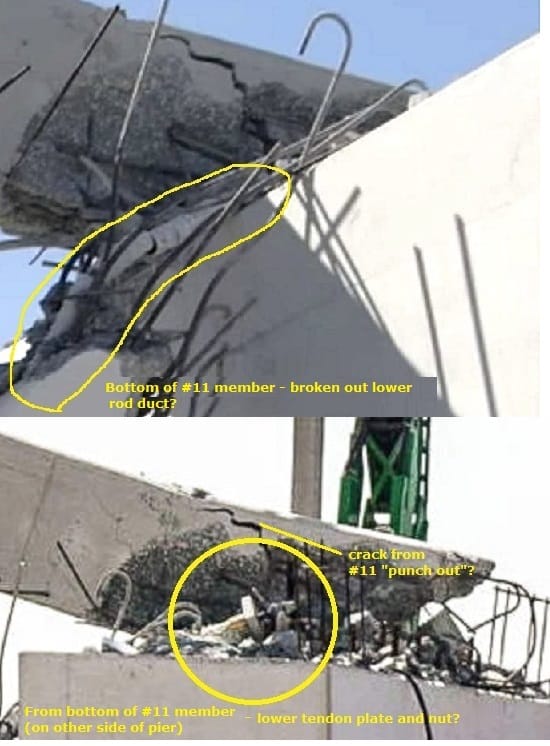

LittleInch: not sure if you were responding to me on PartIV, but my "failure" diagram isn't accurate. I had (too soon) 'assumed' the rod snapped (and didn't make changes). Below looks like #11's upper duct and rod plate/nut protruding from a shattered end. #11's upper rod/duct (not pictured, at ground level - as you already know) was stripped from the member. I'd thought this was the end of #11 leaning against the pier, but it looks like 4'-6' of concrete is missing - rebar is fairly straight (I'd expect it to get bent as #11 sheared from the deck) - if so, the contact points of #11 and #12 are still very near each other, with #11 displaced east.

LittleInch: aside from a video by Meerkat007 18-Mar-18 19:53 in 40ms segments (that may or may not show a projectile and 'dust puff' on north end), I agree the lower rod/jack could be forced out as the deck fell.
Meekat: I agree with Saikee119, that it could be an outboard duct for canopy cable, or could be the duct for the lower rod (not sure if rod/cable ducts are different diameters) - I can't tell... Here's a good photo (can see rod duct at left in shadow)
I'm going through all (about 1/2 through Part II now), but has anyone seen the dead end anchor of the #11 lower rod? Meerkat (18-Mar-18 19:53) said it appears to still be attached to the deck (under a pile of rubble). NTSB roll (Meerkat 19-Mar-18 06:48) got close when they had a measuring tape on the duct, but video didn't show the end.
