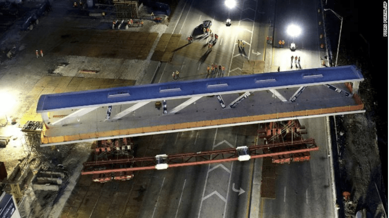

As Gwideman has pointed out previously you need to be careful with the information as Appster posted on 23 Mar 18 22:21 is a animation and not the real thing. While it depicts the method well we do not know exactly the details of the pours. If you watch the video the whole bridge was constructed with a single workman seen. Magic?

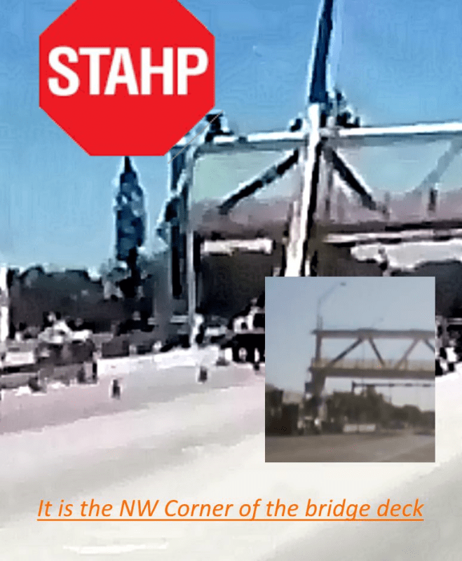

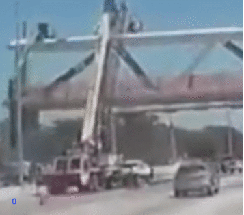

Perhaps the puff is part of the banner zip-tied to member 11. When 12 falls, the puff goes away as banner is pulled down with it. Banner remnants can be seen between deck slab and pylon in NTSB video. Note how the banner shredded on member 3 in clear view on the truck dashcam video.
Slow motion of the collapse from youtube.
slow motion
As the video starts, note the puff of white dust to the right of the worker on the top of the canopy. The dust than dissipates and then returns, maybe blown away by the wind? The dust would appear to show that the worker was chipping away the concrete at the time of collapse, and not post-tensioning. There is then a puff of black on #12, then a puff of white dust on #12 as the collapse begins.
It appears that the bridge fell during the preparation for post-tensioning so that would indicate that the bridge was already unstable or damaged.

I am afraid you are behind with the history. First the north side has a concrete barrier making the original transporter configuration too much work. A change was introduced probably necessitated the PT rods introduced in No. 2 & 11 as No.11 according to the proposed drawing has no PT system. The revised transit support arrangement has two overhanging cantilevers causing No.2 and 11 suddenly taking tension not anticipated in the proposed drawings. The change broke the bridge indirectly!
This was how the bridge supported during execution.

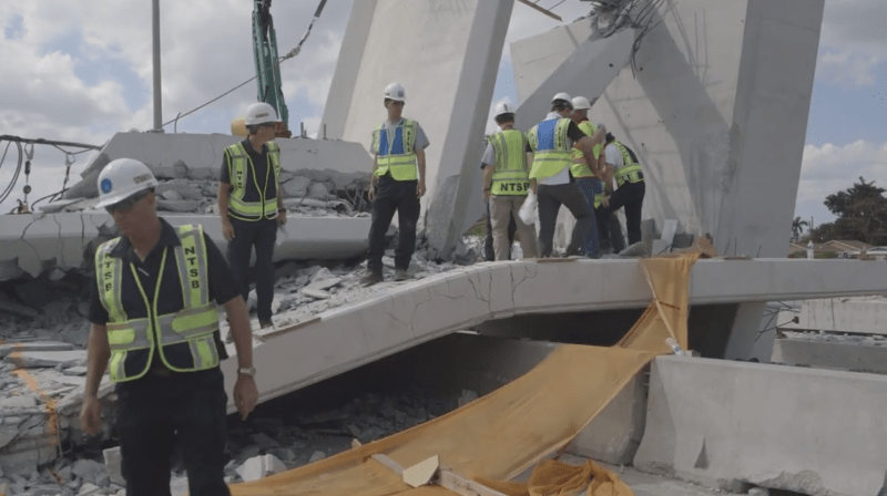

You can see the concrete barrier or divider here. It broke the fell bridge by locally hogging when the bridge failed by sagging. The sagging point is at the lower left corner of the photo.

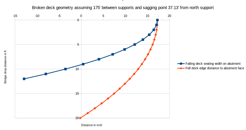

gwideman by post 27 Mar 18 07:53 has already shown the deck could clear off the abutment after dropping about 13'. In view of the interest expressed on the lateral protrusion disappearing during collapse I enclose a couple of graphs showing the movement of the north edge of the deck.
I should say my assumptions differ from gwideman slightly but the overall result is a reasonable match. He assumed the sagging point 36.83' from the north edge while I used 37.13'. I believe he clear the seating width for the full end beam 2'10-1/2" width when the bridge drop 13'. I assume the 175' span between bearings so my deck clearing off distance is half of him and so my drop is only 9' approximately. However my graph does show a 13' drop if the clearing distance is doubled.
The above graph also depicts how much distance the edge of the fell deck from the face of the abutment. Both gwideman and I assume the ground level is 20' from the top of abutment. When the fell bridge lying flat on the ground my graph shows a clearance of 0.25" distance which is not too far off from the actual structure.
The graphs assume the broken segments can be summed back to the original 175 length but in reality with concrete spalled and structure folded at more than one location the total length of bridge could have changed. Nevertheless the blue graph above would suggest the deck was moving south if something were protruding north during the collapse. Therefore it may be a possible explanation for why the protrusion retracted.

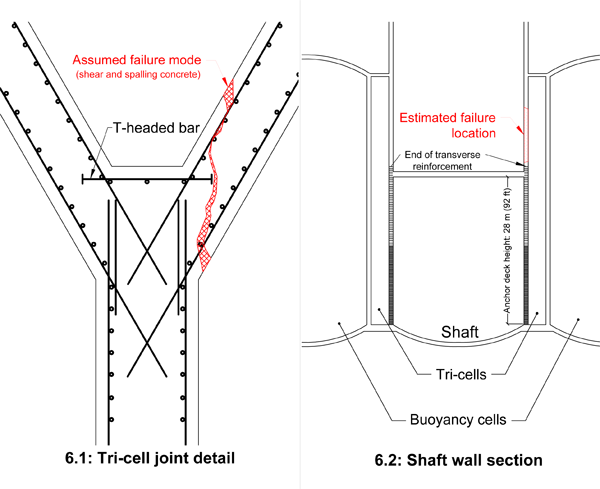

As to software that designs connections, what exists is only capable of designing standard, repetitive-type connections. The FIU bridge would not qualify and the connection details would first need to be drawn, preferably by hand, and then potential failure planes contemplated so that supporting calculations can be made that indicate adequate reinforcement is in place to prevent failure.
A famous example of what happens when this is not done is the $180Million Sleipner A-1 North Sea concrete oil platform that sank in the Gandsfjord outside of Stavanger, Norway in 1991 when it was undergoing ballasting in preparation for the addition of its drilling rig. It failed in shear as a result of poor geometry and inadequate reinforcement. The failure is shown below. If that T-headed bar had extended out to the far surface it might not have failed.

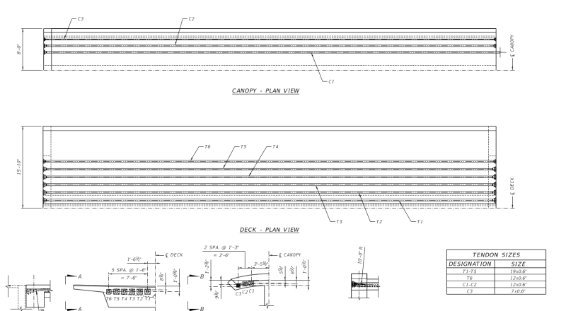

And another. Does anyone have any idea what PT strands were planned for the canopy and when these were to be tensioned before moving the bridge.

Good dwg of the concrete "Y" failure. Please look at the Columbia bridge failure thread: There, another "diamond" diaphragm separated very nearly identical to the oil platform failure you show.

A different thought: Look closely at the rebar as it protrudes from the broken concrete.
It's pristine, clean, clear of ANY concrete blocks or remnants or pieces. Only a light coating of dust. As if the rebar were "oiled" or painted/didn't adhere to the concrete around it.
With the 4 inch dia plastic drain pipes at each connection, would that not also contribute towards a weak jint at each connection?
racookpe,
The clean bars were prestressing bars, not normal grade reinforcement. They were not bonded, just anchored at each end. Whether they were to be bonded by grouting in the final structure, I don't know.

Appster,
Is this what you are looking for the strand arrangement for the canopy and deck?
It is page 112 of the 173-page MCM_FIGG proposal. The web page has been cited several times in this site. Think EingineerEIT first gave the web address on 16 Mar 18 15:04 in Thread 1. I believe it in in FIU site too.
