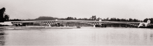

The designs of Robert Maillart may provide some insight into best ways to approach concrete truss. It seems engineers in his time faced much more skepticism from the public than now. Perhaps the public now feels the government is watching out for them...

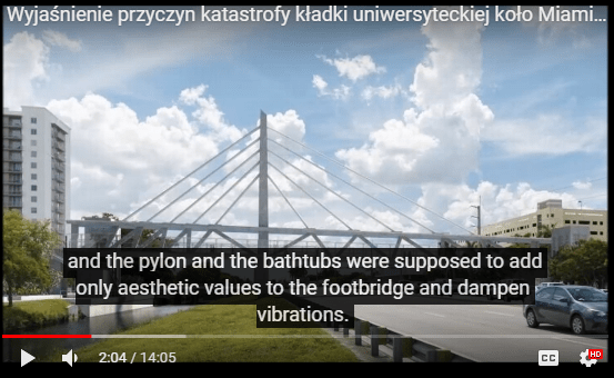

Anyone speak Polish who can translate this? Illustrations look great, anchor at 11 is very interesting. No spiral confinement, no appreciable anchor steel reinforcement. Clean of concrete, a very explosive break. Anchor was to be designed by the PT supplier in the local zone behind the anchor so the plans showing nothing on this.
YouTube speaks Polish:
While viewing the video in your browser:
pause it
just to the right of the "like" and "dislike" thumbs; are three dots ...
click on the dots and select "open transcript" A box with the scrolling transcript will appear (will be in Polish).
Move your cursor to a blank area outside the box and Right click and select "Translate to English"
play... for me the on screen captions are now in English.
What a beautifully drawn and presented video!
Thank you for finding this

SFCharlie: thanks for the info. My computer (old laptop/windows7) wouldn't give the right click option for "translate to english" but I got through it and maybe this works (but I couldn't make it full screen).
THANKS MOJOJOHN! best I've seen and he did it with prelim specs.

Thank you for the instructions on YouTube video translations. I didn't know you could do that.
Works very well for the most part. I like this translation though. Ha!

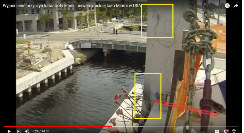

Any ideas on what marking on this sensor may be? Also, what could have caused scorch marks?

This video makes a point that MCM may have been faced with need to destroy span and restart and they could not face it. Can anyone cite a project that was destroyed and rebuilt as a precaution? I feel that the managers of any project MUST be prepared to abort. You can even test for this, but I will not go into that, use your imagination. The video is professional and excellent. Good find.
