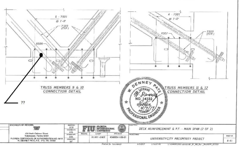

This is something that's been bothering me for a while:
In all instances the longitudinal reinforcement extending from the truss diagonals into the bottom slab and top canopy terminate in a "J" bend rather than an "L" bend. Plus, they often appear to terminate above the outside face slab reinforcement, and are without any crossing bars at the bends. It seems trivial, but it's not. I would think you'd want to securely anchor these within the top and bottom chords and tie the two together. Why was it done this way? Could the designers have wanted to in some way try to simulate a steel truss-like effect in a concrete truss? No answer on this one.
It's little things like this, along with the minimal amounts of mild steel within the structure, the odd stressing sequence, the work point locations for 1/2 and 11/12 being so close to the end of the bridge, to name just a few, that makes me wonder what post-tension, concrete bridge experience the designers had.
Seeing the polish video again and the slow motion dash cam (where would we be without that I wonder), I hadn't fully taken in the fact that the top of no 12 with the top canopy initially falls vertically in the first few frames by quite a long distance whilst the bottom slab only rotates about the edge of the pier.
To me the only way it could do that is if the base of no 11/12 had been pushed out beyond the pier before being pulled back over it as the lower deck got pulled off the pier and the top canopy collapsed down and further into the road.
So sequence was base of 11/12 breaks and moves sideways enough to fall vertically down, top of 11 breaks along with canopy, bottom slab breaks somewhere between 11 and 10 and then starts to fall with base of 11/12 pushed out beyond the pier. It all starts to fold in then as the bottom slab is [pulled off the pier and the top canopy pancakes onto the bottom slab it pulls the top canopy, still attached to no 12 back over the pier to its final resting place.
This is impossible, as top of member 11 remains attached to canopy. The length of member 11 can NOT increase, it can only remain the same or decrease. To push out member 12 this far it would have to become separated from 12 first, which is of course quite possible.
