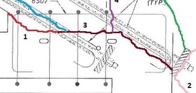

TheGreenLama (Structural) said:
truss diagonals into the bottom slab and top canopy terminate in a "J" bend
In the photo at the end of chris snyder's (Electrical) post above at 25 May 18 20:18
the lower "J" bend in #11 is leaning intact against the top of the pier.
from this I'm guessing that part of the deck exploded along with the ends #11 and #12.
I don't know what that implies about the order of events, but could the PT rod have crushed the deck and bottom of #11?

SFCharlie,
According to drawing B-97 the those J-bars (7-S03) extend into the diagonals 5'-9". The bar visible in the photo looks like a side bar from 11, with the top bars resting on top of pier. They look surprisingly straight. The bottom bars near the bottom PT anchor are still in the deck. The fact that the J is still intact demonstrates the isolating effect of using that type of bend to try and anchor the diagonals into the slab. Beyond that I'm not sure.
Because they are so straight might imply there was NO explosion of 11's base. If 11's base exploded prior to 12 being dislodged you'd expect to see deformation in the J-bars, as 11 would've been rammed into 12. The fact that they're straight could mean that 11-12 moved laterally more or less together, with the base of 11 being ground away by 12 only after 12 became separated and slid downwards and outwards. Hard to say.
Rebar was running the length of #12 (spec of lower area above at 21 May 18 21:37) and likely held #12 together across the cold joint as (I suspect) #12 broke loose at the top of the upper anchor plate (in photo above at 21 May 18 18:40) along crack 6 where it meets crack 2 above (6 Jun 18 21:21).
Speculation... lower end of #11 moved north a bit as #11's lower PT rod was tightened and triggered events - #12 slid down and north, the weak #10/11/canopy connection broke/dropped/hinged, pushing down on upper end of #11 while bottom of #11 hinged toward the deck and PRIED the cage out of the deck, causing the lower end of #11/deck to explode from leveraged tension on the connection (and leaving the PVC tubes ~intact).
Probably need to draw/cut it out, but if #12 was off the north end of diaphragm, and #11 was "laying" on the deck east of #12, the lower end of #11 may not have touched #12 (spalling on south side of #12 from diaphragm instead of #11??)... need to consider only two rods perpendicular to east edge/along #12 are bent a bit, while rod/duct/rebar exposed from bottom of #11 appears intact. Both would have been "laid easy" on top of the pier when the diaphragm slipped off the pier late during north end events.
chris snyder - Finally, someone else ponders if #11 was pried from the deck. I have been trying to work this out for some time.
Just to stir the pot, ask yourselves if there is more of #11 missing from below the canopy than from the #11/12 node? To my eye it appears there is more missing from the canopy end of #11.
Respectfully,
Rather than prying at the bottom of #11, I suggest that the sudden explosive failure of the dead end of diagonal #11 at the base may be due to an dead end anchor failure. We can see in the photographs that there appears to be a lack of any type of confining reinforcement in the local zone of the anchor in the Polish blow up of the video. I would have expected to see spirals or some sort of confining ties that remained after the failure, wrapped around the pt bar and duct. Possibly some voids behind the anchor to contribute to weakness? The much discussed shear, cold joint and cracking all could have contributed to this the failure.
Remember, the anchor details in the local zone are by the PT supplier, so we have not seen them yet.
The anchor plate does also look small, not 8 x 12 as specified, but this is hard to tell from the photograph. I calculated about 1 3/4" thickness for the plate with 45 ksi steel, which looks about right for the threaded bar and nuts.
The cleanness of the bars and pt suggest an sudden failure under great force (280 kip released suddenly, maybe another 280 kips right behind it in the top pt bar.)
After the anchor failure, the lightly reinforced #11 diagonal, with no shear reinforcing and minimal column reinforcing failed catastrophically. The member was also designed for compression only with little room left for moment that may have occurred due to uneven pt force at failure.
With member 11 gone, member 10 went from tension to small compression (only local, not truss forces) and member 9 remained a compression member putting its full force on the deck which was no longer a truss, but a beam to the north and sudden and total failure occurs.
Respectfully submitted
Prying on #11 can't really happen until very far into the collapse. A feature to note is that the deck was clean of #11 even though there should be a lot of rebar in place. If #11 was pried loose those rebar pieces would be sticking up like dandelions similar to the way that they stuck out where the bottom of #11 was torn out by the post-tension bar. Instead it appears they were sheared clean off, even with the top of the deck.
The anchor at the bottom of #11 retained enough grip to tear through a significant amount of reinforcement in #11; that suggests that there was no damage to the anchorage. I believe any load through the lower post-tension bar was relatively slowly relieved due to the inertia of the concrete mass.
A significant amount of damage was done to the upper end of #11 as the axial load that it was supplying was lost and it was converted to a cantilever, along with the canopy, temporarily sharing the load until they too succumbed as the rest of the bridge rotated from the south platform due to unbalanced gravitational loads. The load transfer to the canopy was delayed because the reaction was through #12, but #12 was displaced from the deck by the movement of #11.
I think the critical movement was less than a few inches, perhaps as little a one inch of shear, at the bottom of #11.

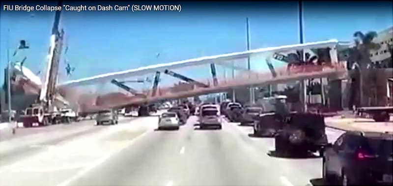

Deck hinged 11/12 and fulcrum upward and backwards before deck was pulled out from underneath it.
This video will resolve your questions on why the PVC pipe presents with ''no damage'' and the reinforcement being in such great condition. Also, explains why some of the bottom of 12 and 11 are ''destroyed''.
Further, the "Polish guy's video" has the top of the canopy ''pivoting in mid air!" - that video should totally be discounted.

Interesting video above. I saw a bit about the fall begin ~30:00, about #12 breaking from deck ~31:35, and more about the fall ~40:00. I didn't watch entire video, so missed explanation of exploding concrete. I may watch all later - the author brings up some good points but it takes time to get them...
Been thinking about tension cables maintaining deck and canopy length while providing hinge points, and what happens to the diagonals (esp #11). Video shows a white area on #11's banner - can't tell if this moves much (would need to move north to sheer bottom end). The #10/11/canopy connection and canopy are weak, so it's possible this broke and top of #11 moved south (per epoxybot above) while the rebar held at #11/12/deck until it (maybe?) pried out. In any case, a LOT of weight would transfer to top of #10/11 during collapse, with bottom of #11 ~held at its elevation.
Thanks to MOJOJOHN's and others for input. The only things I'd say are ~definite now are #12 moved off the end of deck, #12/canopy joint stayed at a right angle, and the deck and canopy broke/hinged but stayed the same length.
To do an accurate cutout model (appreciated that video..), the whole span should be set up with a canopy hinge at the north end of #10/11/blister, a deck hinge at north end of #9/10/deck, with the south end of span hinged at the pier (this was on bearings and had moved north about a foot when #9/deck ~touches the ground). Would look at the collapse up to this point - the canopy break is ~touching #11 which is lying ~flat on the deck.

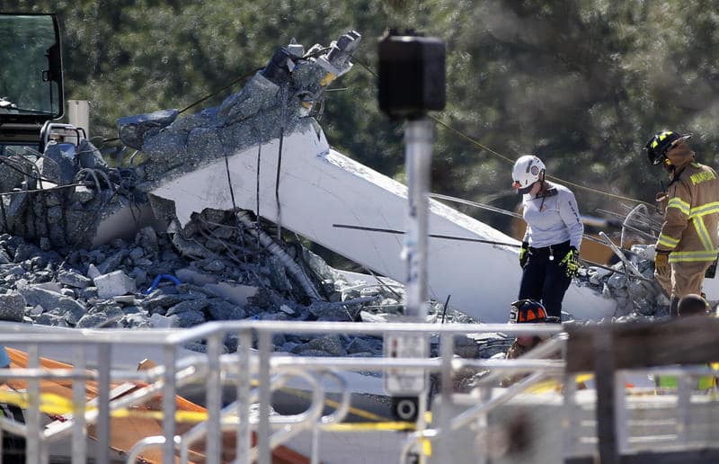

Below is photo of #9 - this had no PT rods, but punched through the canopy and remained ~intact, while #8 diagonal (with 4 PT rods) broke up. The blister at #8/9 shattered. This got hit with different forces, but seems to indicate the blister/canopy/truss areas were weak (may be able to measure photos to estimate how much of upper #11 is buried).
One other thing (bugged me since someone asked "What happened to the cage?") - is this a welded or wired assembly, and is this the rebar MOJOJOHN said would shear when #11 moved north? Is hard to imagine the cage lifting or shearing without affecting the lower rod anchor (seems cage moving out would break/loosen up the concrete, but lower anchor held tight to strip the lower rod).
It takes a shear movement of less than half the thickness of material to separate it. Since the re-bar is smaller than the clearance of the post-tension bar inside its sheath it is easily possible to cut all the re-bar at the deck surface and leave the post-tension bar unaffected.
