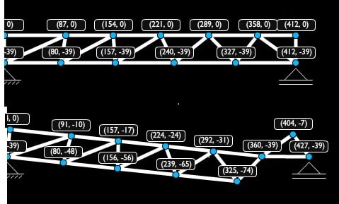

TheGreenLama is correct, very small movement of 11 lead to collapse. This is counter-intuitive. What allowed for movement is unknown to us at this point. Once 11 moved (or its confinement moved) over a certain tiny threshold the bridge became a machine. No longer static, so now in the discipline of mechanical engineers.
The amount of motion required is proportal to the elasticity of the structure. Here the truss works against the stability of the bridge because its overall ridgedness, combined with 11 not being confined, locally concentrated energy to member 10. Then the 950 ton lever-hinge-parallelogram machine proceeded to wreak destruction. The failure of 11 was very brittle, hence very little deflection before bursting.
All illustrations I see show 11/deck shear motion as large, i.e. Polish youtuber. The best way to understand collapse (not cause) is to just assume 11 is cleanly removed in an instant. This reproduces mechanism of collapse (but not the root cause of failure) : Truss theory and behavior is actually very involved and something very few understand fully. P.S. Strictly speaking, in technical terms calling this overall structure a truss is a misnomer. But individual sections of it are truss-like. All of this means this one-off design has to scrutinized from scratch and empirically tested.
Ms Figg video reminded me of Feng-shui and Numerology. That's unfortunate. Was March 10 move date based on newspaper Horoscope?

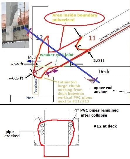

The cracking evidence is that the bottom of #11 slid across the deck, while the lower (4" tall?) side was being held back by a stirrup. Then they prestressed #11 to 560kips, & transported. The next step would place the bridge on pier with full 2,000 kips load at small 1/2 size #11 fillet block. #12 held tight, & #11 slid to crush small undersized fillet. The #4 pict crack is probably 2x the .024" travel I figured was needed to explode fillet.
I'm curious if they didn't tighten #11 rods beyond 560 kips to try to close cracks. The span survived moving with 560, though de-stressing rods (joint would move a bit), then re-stressing (to 560) may have had other effects.
Diagram shows pulverized area (with klugey fix to hold joint..). Cutterhead said "explode" twice and I wonder if this could be literal. Odd that #11 rebar at top of pier isn't bent and duct is still intact (some spalling on #12 as #11 rode up, but I suspect ~half of #11 was off to east side), and the PVC tubes in the deck didn't break up (though one cracked).
This using Meerkat's post and his input data
22 Mar 18 12:04
shows end of #12 (with canopy held at right angle, hinged at #10/11) would move about 6 ft north before it starts moving back, which agreed with an estimate from slo-mo video (only about 2 ft can be seen). A bit odd that pier on north side shows no spalling at top edge - seems #12 was on the diaphram which didn't fall until rotation was almost finished. The "no shear" video at 10:25 cites only one piece of rebar bent on top of pier north of #12.

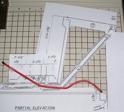

A better image after collapse using old-school (2nd-grade..) technology. Shows about 20% of #11 chopped by canopy - from video and photos, the canopy broke at north end of blister (a dark spot appears on side of canopy in frame after "worker latches up"). The piece of wire represents lower PT rod - shows about 7 ft of unbroken PT rod would come out.
chris snyder,
Your old-school cutout method is actually commentable.
When all the math on this design is rechecked, it may come back that the triangles in the truss where too large for the behavior of the thin deck and canopy. A Baltimore, X, or double stacked truss may have been better. In addition it should have had two inline truss systems running down the middle. Same or similar total cross-section and weight, just two seperated. Most importantly, the end members could have massive sear walls since they are near pier and would not add that much moment. The pier should be larger too. In the end they stuck with ABC and faux stays, so 11 had to be thin.
This case in textbook example of designers painting themselves into a corner.

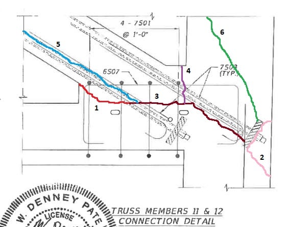

Here's a possible sequence of events at joint 11-12 based on observed cracks, and the little we know, borrowing heavily from earlier posts. Cracks noted sequentially by numbers. It's a good story. Whether it bears any resemblance to reality is an open question:
1) Observed crack prior to move, a result of dead load. Story should have ended here. Remedial action should have been taken (if possible?), or bridge destroyed and begun anew. Maybe stressing of temporary PT in 11 partially closed crack; maybe it did nothing other than give a false sense of security.
2) Move occurred. PT rods destressed. Crack reappeared. Temporary PT in 11 was now called on to close crack and save bridge. Assume both PT rods are stressed, possibly above what was done in 1. Tensile cracks may begin to appear behind top PT bar anchor plate.
3) With no dedicated confinement steel in front of anchor plates tensile forces acting perpendicular to the PT rods cause crack to propagate. Dead load also continues to work on crack. Shape and depth of crack beneath 11-12 indeterminate. Two things conspire to separate the top PT anchorage from the slab. Shear force from 11 now pushes horizontally against top rod, and PT force acting on top anchor plate will initially want to pull it upwards. Pictures show a very neat cavity between the nearly undamaged PVC pipes on either side of 12 within the diaphragm, possibly the result of top anchor plate bursting, or shear, or a combination, so crack at deck surface would fall inside of PVC pipes. Stress in top PT bar now goes to zero. Axial load in 11 now generates shear failure along this 1-2-3 plane. This begins collapse sequence. More on this below.
4) Slight movement along 1-2-3 plane causes load redistribution, resulting in hinging at various locations. Hinge points are top canopy, bottom of 11, top of 11, bottom slab, and even base of 12, with the order possibly being as noted. With the tremendous loads acting here, there's no reason to believe 11 would remain attached to 12 for long.
5) Bottom PT rod is torn out as 11 rotates and slides out.
6) Face of 12 is ground away, partially from 11, and partially as it slides downwards and outwards along back edge of diaphragm, once bridge has fallen far enough for 11 to push it beyond diaphragm.
Questions:
--What is the horizontal movement necessary along the 1-2-3 plane before collapse sequence and hinging is initiated? mm or cm? Because bottom PT bar remains attached to slab we're probably only talking mm's.
--Why does bottom PT rod remain in slab? It's sort of obvious when looking at the picture, but still unsure.
--Neither mild steel chevrons placed in deck slab, nor placing longitudinal PT along the centerline of bridge, would have likely prevented this potential failure mechanism from happening as crack 3 could also progress along top of slab to near top anchor plate. Plausible?

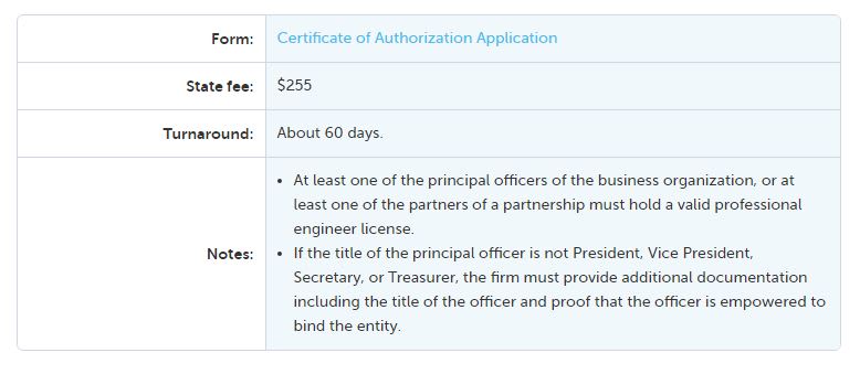

Here is a more detailed explanation. I was referring to the Principal (officer of the business) listed on the Certificate of Authorization of which there can be only one Principal. By the way, the referenced table appears to be copied off the Harbor Compliance website, not the FBPE.
Of course there may be more principals as part of the firm ownership. However, Florida requires the other principals to be subordinate to the one Principal officer of the firm that is listed on the Certificate of Authorization.
Here is the application:
Application
Here are the paragraphs:
"Please list the name, business title, Florida PE license number and address of the professional engineer who is the principal officer of the business."
"If the PE named as a principal officer is not named as the President, Vice President, Secretary or Treasurer of the Corporation, or Limited Liability Company (LLC), then the application must be accompanied by documentation from the entity’s charter or bylaws which provides the title of the officer and that the PE named as such officer is empowered to bind the corporation or LLC in all of its activities which fall within the definition of the practice of engineering as that term is defined in Section 471.005(7), F.S."
The other point that I made is that if the owner is not the principal officer of the firm, then it may be an awkward situation where the owner is working under the direction of the principal officer of the business.
Also, I did not say it was weird which implies something supernatural or uncanny. I posted that it was odd which is defined as unusual as engineering firms do not have great career paths for non-engineers.

TheGreenLama, I like the sequence - especially the crack pattern. Will think on it more.

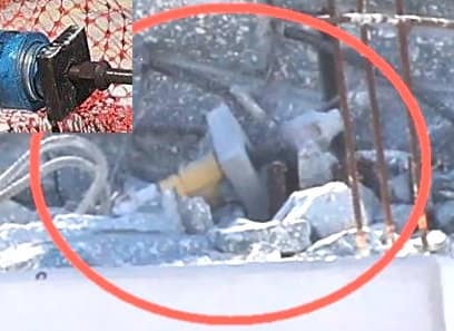

I must be wrong about #11 walking up #12 and going east... only 2 pieces of rebar on that side of #12 are slightly bent.
I still wonder if the #11/12/deck joint (brittle concrete?) could literally explode. About 4 ft are gone from the bottom of #11. I can imagine it breaking apart (as did #3), but that area is pulverized like dynamite blew it apart... it would take LOT of concentrated energy to do that.
I looked some, but didn't see much reinforcement/rebar in the blisters or canopy. Neither looks very strong (shouldn't have to be), but there wouldn't be much holding the #10/11/canopy joint together. #10/11 blister popped off, and #9 diagonal punched through.
#11's upper rod anchor plate bugs me - more after reading your crack sequence. This is spec'd at 8"x12" for a 1.75" rod, but it looks ~8" square (~same as the jack's plate).
