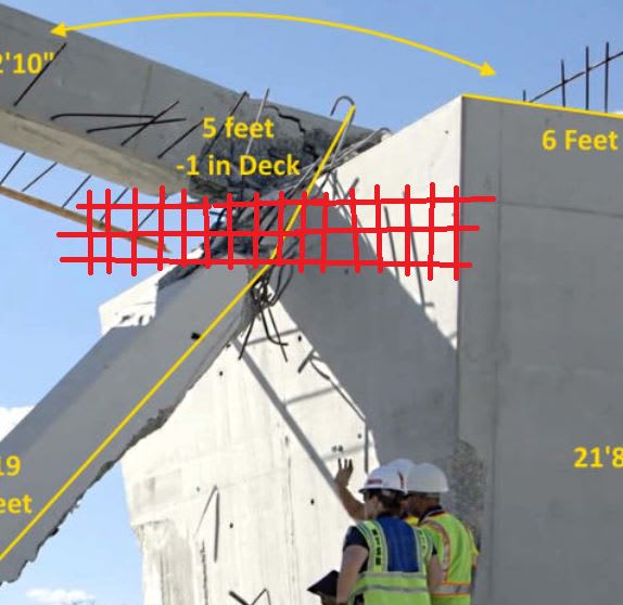

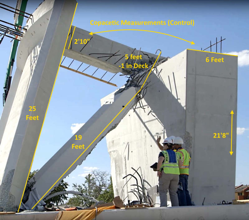

I am wrong about the top of #11 missing more section than the base. What is somewhat interesting is that the remaining north portion of the canopy is longer than the distance from the end of the canopy to the front of the #10/11 blister. The distance from the end of the canopy to the beginning of the blister is 21'-10", while the remaining north section of the canopy is approx. 25 ft.

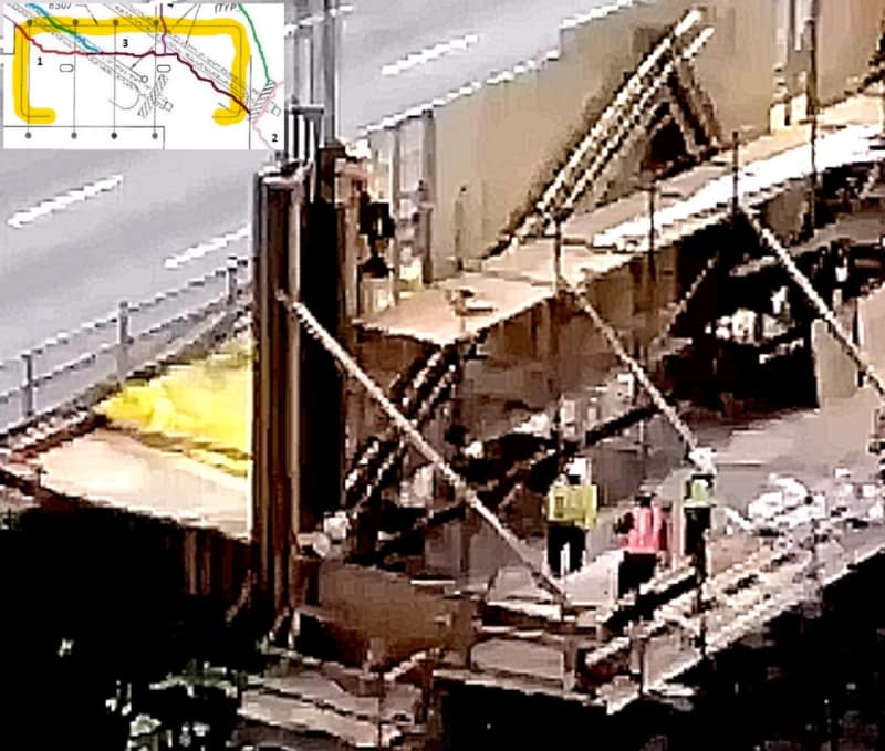

Watching the Dash Cam video, #10 maintains its top & base geometry in relation to the south portion of the bridge as it falls. This cannot be said of #11. The #10/11 node is positioned south of the center of the #10/11 blister. The canopy breaks directly in front and around the sides of the blister. There is obvious rotation of #11 around the #10/11 node. It is not as easy to gauge the rotation of #11 at its base, in relation to the deck.
There is very little damage to the diaphragm. Even the recess between the PVC pipes is less than a foot deep. In the photo of the NTSB staff examining the PT bar they are all standing atop the rubble strewn deck.
While there is no explanation as to why, it is possible that #11 buckled under the #10/11 node & the very stout & grouted #10/w node & @95% of the bridge mass attached, hammer #11 rupturing the base (allowing both ends to rotate) and sending #12 sliding off the back of the diaphragm. The sliding of #12 accelerates the rotation of the #12/canopy section while the base of #12 traps the bottom of #11, at which point the diaphragm is yanked off the pylon and the lower PT bar is disemboweled from the trapped #11 truss.
The problem I have with this scenario is that it would seem that both PT bar should have extended somewhat beyond the blister.

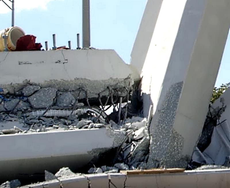

This photograph says it all. The bottom of #11 should have been tied into the deck with a massive amount of steel in the form of a load spreader beam, as indicated in red in the image below. Only problem, is that the shear stress at this point was so high that not enough steel could have been provided to satisfy the code requirement. It is quite evident that the person who designed this bridge did not have even a rudimentary grasp of the flow of forces through the structure, nor of how to cater for those forces through the imposition of structural elements.
FIU had grand plans for 'signature' bridge. But the design had a key mistake, experts say...
That resulted in a support piece that was likely not thick enough, and even more significantly, lacked sufficient steel rebar reinforcements at the point where it connected to the deck, all three engineers who reviewed the calculations said. That meant it could not adequately withstand the load of the bridge weight it was meant to carry, nor resist "shearing" stress at the connection to the deck that tended to pull the base of the diagonal strut from its anchor, they said.
