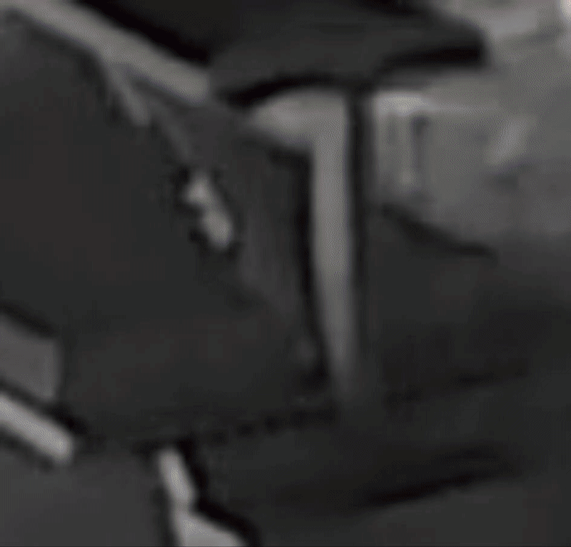

I added a ZIP file of North View closeup images enlarged by Nearest Neighbor interpolation to my post of 16 Jul 19 02:17, [highlight #E9B96E]highlighted with tan background[/highlight]. You should use both the smooth and chunky versions to guide your assessments.
ADD: I also added a second ZIP containing a batch of 100 control images taken at the same time on the previous day so you can see what the North View closeup looked like when it wasn't being worked on.
MikeW7, basic question. In your posted GIF, why does the back side of member 12 have a very large jog in it about 6' up from deck?

This "bulge" is present in the North View timelapse all the way back to when the bridge was installed, but photos around that time don't show any sort of protusion other than the 8" drain pipe that extends out about a foot.
My guess is that the "bulge" is an interpolation artifact related to the drain pipe. If you look at the PB-NN comparison images in my 16 Jul 19 02:17 post, you'll see that the horizontal extent of the drain is not apparent in the black-gray pixels, so the interpolation routine saw those pixels as a flat oval shape and probably just conformed some of the tan background pixels to surround it. This bulge is formed by a small area of about 5x10 raw pixels, so it should be easy to understand that when each of those pixels is replaced by a block of 16x16 interpolated pixels you're sometimes going to see the appearance of wierdly shaped "details" that don't really exist.
High power enlargements can be enhanced to "guesstimate" the shapes hidden in a small group of pixels, but not the details, and sometimes the "guesstimations" are incorrect. That's why I've been stressing that you should only look at original pixels when you're making critical judgements, because that's the only real data that exists. If you can't see it in the pixels, it ain't real....

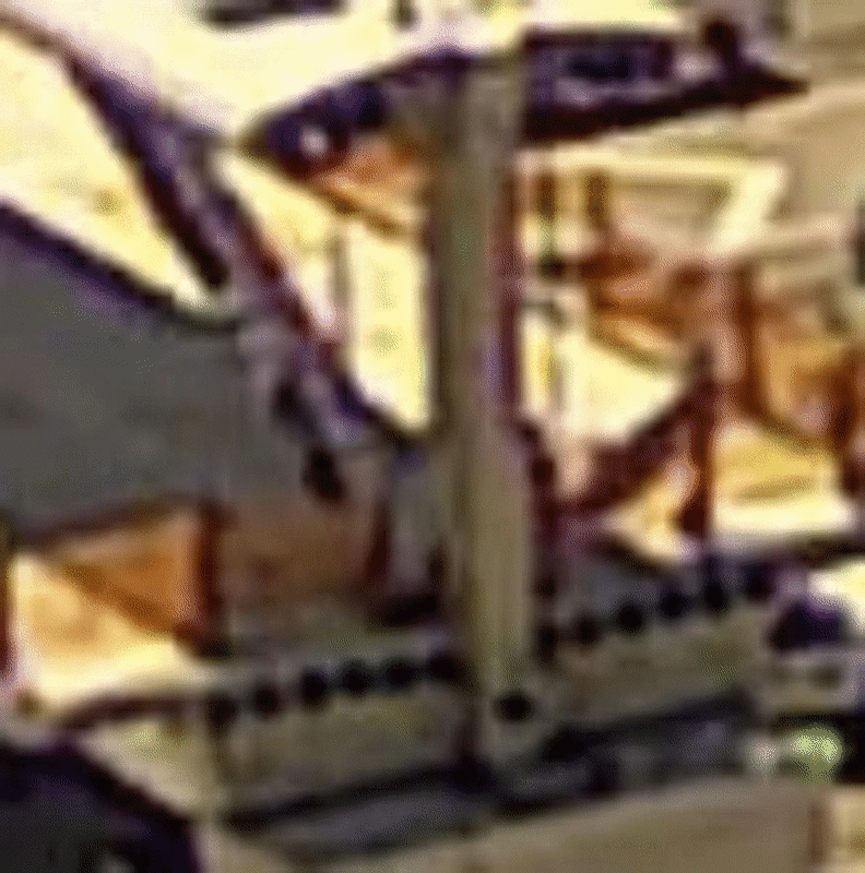

I seem to see the east edge of the top of the deck slightly tip down away from the diaphragm in the last frame or two before the collapse? I moved the right half of my browser window off screen, so the motion there would not distract or influence me. Can that be real?

I seem to see the east edge of the top of the deck slightly tip down away from the diaphragm ... Can that be real?
If you read my 16 Jul 19 15:38 reply to TheGreenLama you'll see that the raw pixels representing the extended drain pipe were recorded in such a way that its North-South extension appears as a flat, right-left horizontal oval. I just looked at the canopy area by simply moving the crop window up, and did not observe any kind of vertical movement. Using an analogy similar to the drain pipe mystery, I think the apparent vertical movement we are "obviously" seeing is in fact an interpolation artifact of what is actually the northward kickout of the 11-12-deck joint and diaphragm area that OSHA described as a blowout.
We are all in uncharted waters here. We have to understand that what we are seeing is very "real" in some way, but the actual reality behind it is subject to interpretation, so we need to develop a set of interpretation standards before this devolves into a quagmire of competing SWAGs.
ADD: ZIP file of last 44 frames of North View closeup, cropped to include the entire north end (canopy, member 11, deck, and pier top). This time I remembered to put them in a folder. I also added this ZIP file link to my original post.
ADD: I'm editing my original post with ADDs as new insights are discovered, such as this "Is it vertical or flat?" conundrum.

MikeW7 You have done so much work, I can't complain. The new crops do not show as much of the east edge of the deck as the old ones. This is where I though I saw the slight rotation downward about the east-west axis.
ADD Oh, I guess that I was looking at the shadow of the top of the orange safety barrier, not the edge of the deck. My bad!

Viewing these interpolated images is the equivalent of trying to figure out what's behind a wall of glass bricks. There is only so much you can do to make it look more normal.
You have to remember that the PB (smooth looking) enlargements are representing the exact same detail information that's present in the NN (chunky looking) enlargements, and no amount of filtering is going to recover the details that were lost when the original scene was digitized into chunky pixels. It's frustrating because the smooth edges look more realistic than the chunky blocks, but it's an illusion...

Yeah, it's the shadow of the safety netting, which appears as a fat line because the sun is at high noon. I had problems with it as well until I realized that the shadow was just starting to creep onto the west edge of the deck when the bridge collapsed.
Another spooky coincidence, like the flash of reflected sunlight off the manlift arm just as the north end blew out.
CSI work is fun!
ADD: The fact that the North View images were shot in burst of 3 followed by a delay can be confusing as heck also. You're watching something change slowly over 3 frames then BAM. This is especially true with shadow movements.
MikeW7, I hate to throw cold water on your lengthy and very detailed post, but what I think we're seeing in the GIF is not real. Member 12 moves up and down WITHOUT any associated noticeable horizontal movement. I don't see how this is possible. Particularly the upward movement--and seen from a camera that's how far away?
... and seen from a camera that's how far away?

If it were some kind of artifact, why is it visible only in this region, and why would similar but smaller disturbances be visible in the same region, and only during the time period that the canopy crew was working?
The camera distance is not a factor because the entire image is uniformly focused and rock steady. There's no heat shimmer, focus drift, etc. There are a couple of frames with camera shake in this video, but they affect the whole frame. The 100 control frames I posted (from the previous) day show some wind buffeting and small random movements of member 12, the drain pipe, and the tendon sleeves, but they don't show the non-random up-down motion of member 12, or the repeated distortions visible in the west diaphragm.
As for the up-down motions: from my post dated 16 Jul 19 16:39
...the raw pixels representing the extended drain pipe were recorded in such a way that its North-South extension (of the pipe) appears as a flat, right-left horizontal oval. I just looked at the canopy area by simply moving the crop window up, and did not observe any kind of vertical movement. Using an analogy similar to the drain pipe mystery, I think the apparent vertical movement we are "obviously" seeing is in fact an interpolation artifact of what is actually the northward kickout of the 11-12-deck joint and diaphragm area that OSHA described as a blowout.
What we are seeing is real, but what exactly it represents is still being determined. I've included as much information as I can, including a set of control images from the previous day, so people can make informed decisions.

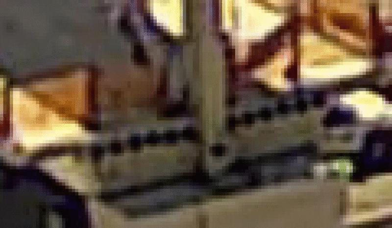

We all know that 12 is of fixed width for the full height
Vance Wiley (Structural) 17 Jul 19 00:16 said:
I can't see what you are describing as vertical movement in 12
Yet is seems to be wide at the bottom, which implies that the west edge of 12 is almost perfectly located between two columns of sensor, but the camera is probably not exactly vertical so the top of 12 only strikes the left column of sensors while the bottom part strikes both the left column and the right column. As a result the top of 12 only gets interpolated toward the left, while the bottom gets interpolated to the left and right, making it look like 12 suddenly widens at the bottom. This sideways interpolation carries over to affect up to 16 other columns of interpolated pixels, so the effect is much more dramatic that you might first expect.
This effect might also explain the dramatic rise and fall of 12 - its bottom edge might be almost perfectly located between two rows of sensors, and a small vertical displacement de-activates the bottom row of sensors, and removes its presence from up to 16 rows of interpolated pixels, making it look like 12 rises up dramatically.
Easy explanations, once you figure them out. There will be many more of these types of puzzles to solve before we get a good handle on what's going on....
I'm not an artist, so it would be nice if someone can illustrate these concepts, then I'll figure out how to incorporate them into a "user Guide" at the end of my lengthy introduction.
ADD: Sped-up GIF of North End from predawn to collapse. Watch the right side of member 12 and how changes in lighting/shadow affect it's apparent width. One more reminder: The purpose of this 16x enlargement is to make motion easier to detect, which it does well. It was never expected to enhance details.
