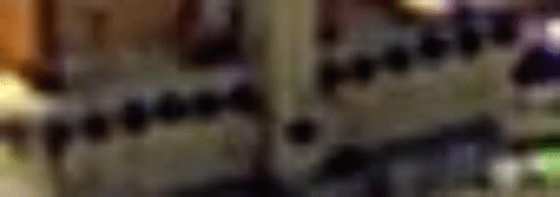

THE SMOKING GUN
So ........ I found a "smoking gun" late Saturday night, hidden in plain sight and already viewed countless times. I spent the last two days figuring out details and writing this post. It turns out a small cluster of pixels can tell quite a story if the right questions are asked...

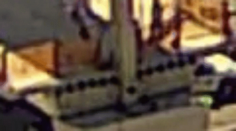

The GIF above shows the last 20 frames of the North View timelapse, zoomed in by 16x. The order of events are as follows:
[ol 1]
[li]Kevin Hanson is standing in shadow to the right of member 12, looking at the 11-12-deck joint.[/li]
[li]Hanson moves to the NW deck corner (possibly to talk by phone with his canopy crew).[/li]
[li]Hanson moves in for a close up view, then returns to the NW corner.[/li]
[li]Just as he leaves, member 12 starts moving up and down and the diaphragm to its west lifts upward - watch the area to the right of the 8" drain.[/li]
[li]A short pause is followed by the collapse of the bridge.[/li]
[/ol]
The GIF was made from individual JPEG frames using the GIF Maker at
It turns out a large section of the North View timelapse, about 170 frames to be exact, documents Hanson's movements as his tensioning crew works on the canopy, and the warping of the 11-12-deck joint that resulted from their actions. Most of these structural movements are much more subtle than the coup de grace that finished the bridge, but they seem to follow a predictable pattern of adjust and wait.
HISTORY
This all started with the Saturday discussion about a dust cloud that was observed (in the truck dash cam video) at the north end just before the bridge collapsed. I began with the North View timelapse source video and zoomed in by a factor of 8x, then 16x, to observe the north end itself, and what went on as Kevin Hanson was actively checking the cracked areas while his tensioning crew was making adjustments on the canopy.
What I saw was unexpected and remarkable. The bridge collapse was not an instantaneous event. The 11-12-deck joint and surrounding area was experiencing repeated cycles of distortion and relaxation as Hanson's crew worked above. I spent most of Sunday experimenting with deciding how much enlargement to use, what type of interpolation to apply, whether other filters might show clearer results, and documenting when critical events occured. Today I worked on this writeup, which took a lot longer than expected.

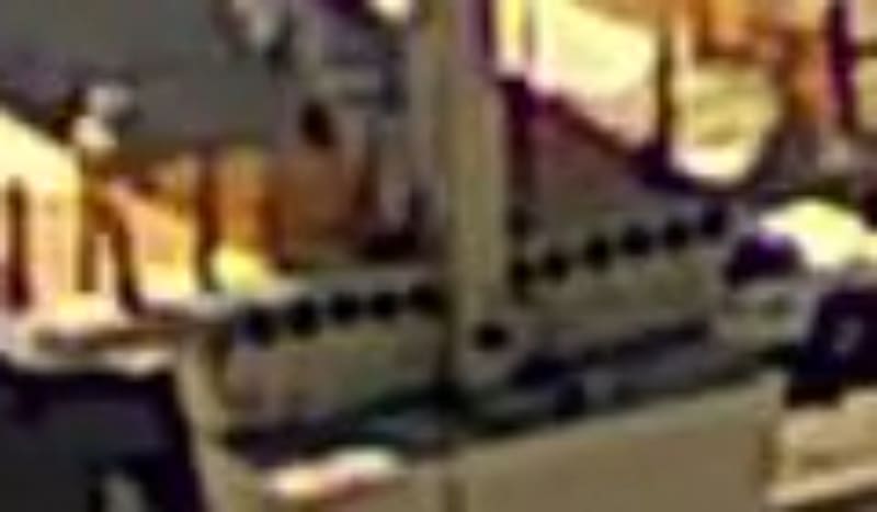

A comparison of Nearest Neighbor (NN) and Precise Bilinear (PB) for a 120x67 crop are shown below:
16x enlargement of cropped Frame 26293 using Nearest Neighbor (NN):
16x enlargement of cropped Frame 26293 using Precise Bilinear (PB):
As you can see, PB is useful to "guesstimate" the shapes hidden within blocky pixels, and at 16x it was very effective at magically converting square pixels into believable representations of the 8" drain pipe and tendon sleeve openings in the north end of the deck, as well as the proper shapes of member 12 and Kevin Hanson.
Much more important, however, is the fact that PB can detect subtle motion. As a sharp feature moves within the area covered by two source pixels, the pixel colors change value to provide an indication of the changed location. If 2x interpolation is used, movement can be detected at approximately 0.5 pixel resolution. 4x interpolation yields 0.25 pixel resolution, and so on. Motion detection at 16x is down to 6% of a pixel width, which means very subtle motions can be detected, like the displacement of member 12 and diaphragm warping.

The frame sequence begins with the departure of a mystery person who was talking with Hanson. After that person leaves, Hanson actively begins checking the cracked area at the 11-12 node, walking from one side of 11 to the other, and at times just crawling over 11. He stops often in the NE or NW corner where he appears to be having conversations with his work crew using a phone, since his arm is held up to the side of his head instead of his mouth as would be the case with a walkie-talkie. In one or two cases there appeared to be lengthy conversations, possibly with an outsider. (Any guesses??)
Here are my notes on what I THOUGHT I saw, using the last 3 digits of the frame number. Your opinion may differ....
252 The west edge of the canopy shadow has already moved several feet in from the deck edge. The actual NW deck corner is defined by a post at the upper RH corner of frame, and the NE deck corner is defined by a post at the center LH edge. The deck corners will be easier to locate in later frames as Hanson moves from corner to corner, apparently having phone conversations.
252-263 - Hanson is standing with an unknown person in the canopy shadow to the right of member 12.
264 - With the mystery person gone, I assume the tensioning process is now beginning.
266-267 - The diaphragm appears to distort while 12 does not move.
276 Camera shake.
281 - 12 drops.
282 - 12 and the west diaphragm clearly drop with respect to the pier (after slowly being raised?)
285 - 12 and east diaphragm rise.
286 - 12 drops.
299-301 - East diaphragm distorts.
306-307 - Camera shake.
313 - 12 moves
314-415 - The diaphragm and 12 are in almost constant motion against a stationary pier and background.
314 - A dark gap appears to the east of the 8" drain. The 12-deck boundary appears to lighten and darken throughout the video, but in this case it is more pronounced.
336 - Camera shake.
348 - The dark gap reappears.
354-374 - Hanson appears to have a lengthy phone conversation. (Outside call??)
390-395 - Hanson has another (shorter) conversation.
NOTE: The descriptions below also apply to the 7 frames that make up the opening GIF.
416-420 - Member 12 moves significantly down-up-down-up as the surrounding deck area warps dramatically.
421-422 - A short pause.....
423 - And the bridge is gone.

MikeW7 said:
It appears that an intervalometer was used to make the camera shoot a short burst of three frames followed by a multi-second time delay.
The frame delay can be estimated by comparing this video with the dash-cam video since the delivery truck is seen leaving the yard and then coming back into view with the collapse.
Regarding the apparent deck/12 movement just before the collapse, again relying on the three frame bursts, in the last three frames prior to the collapse, 420-422, the deck is steady. In the previous three frames, 417-419, there appears to be movement at the lower end of 12 and adjacent diaphragm. More specifically, the drain pipe drops down one or two pixels in frames 417 and 419. Frame 418 finds the drain at the same height as in the preceding and succeeding sets. This puts the attention on frames 417-419. Sad to say I don't have any theories. Insert more info here --> [3eyes]
