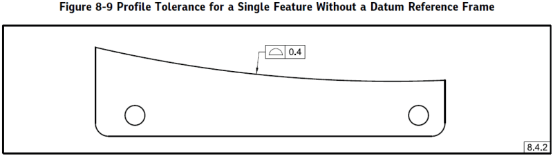

Very interesting discussion - sorry I'm late joining in. There are a few different issues lurking here - some will be easy to deal with and some will be very hard. I agree with what pmarc said already, but I'll try to add a few things.
Before dealing with dynamic profile, we need to get a handle on what "regular" profile actually controls. Y14.5 breaks down geometric variation into form, size, orientation and location. But sometimes these categories don't suffice.
A profile tolerance with no datum features is described as controlling form and size. This makes sense on features that are "closed" - in other words, they have directly opposing surfaces (even if they are not regular features of size). For "open" surfaces that are not opposed at all and really don't have a size-like aspect, then is it form only? What exactly is form then? These are very good questions.
We tried to deal with this in Y14.5.1-2019. As we have seen, it can be very difficult to define things in terms of controlling size, form, orientation and location. These terms can be subjective and very case-specific. So the approach was to focus more on the tolerance zone and the constraints on it, and then let the descriptions follow from that. A profile zone, by default, is defined by two boundaries that are disposed about the true profile in a particular way. The zone is a rigid body - it has no transformations. These property tells us what will be controlled in a variety of cases, much more than a description of form/size/orientation/location.
There is an example that was specifically designed to address the type of case being discussed in this thread. It's a single arc-shaped feature with a datumless profile tolerance:

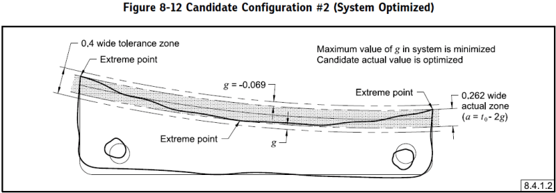

What does this control? The feature is not even close to opposed, so it doesn't really have "size". If we look at the final "means this" figure, we can get an idea:
The as-produced surface is roughly arc-shaped, but its radius of curvature is smaller than the radius of the basic surface. The tolerance zone is a rigid body so it can't transform to adapt to this. We can see that if the curvature was much tighter, the surface wouldn't fit in the zone. In other words, the zone is arc-shaped but it won't accept an arc of any radius.
I would say that this zone controls form and curvature. In the text we ended up saying that it controls form and size, to be compatible with the language that Y14.5 uses. But really, it's form and curvature. In the end it doesn't really matter what words we use to describe it, because the original zone definition (rigid boundaries centered on the true profile) tells us what we really need to know.

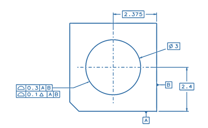

In this first example below, the dynamic profile controls form, orientation and location of the cylinder, independently of size (curvature), as described in "11.10.3 Dynamic Profile Tolerance Applied to the Lower Segment of Multiple Single-Segment Feature Control Frames".

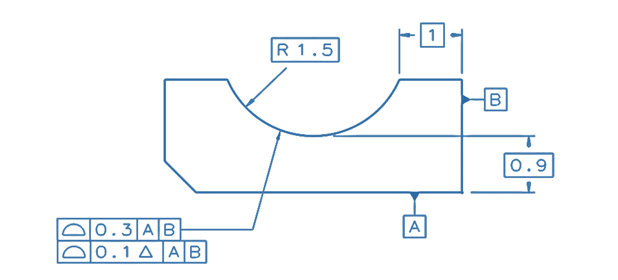

In this second example, the part from the above example is cut so that only a portion of the cylinder remains as an arc with no opposed points, and now an attempt to control the feature the same way will result in failure, because the location constraints relative to the datum reference frame makes the requirement of the dynamic tolerance zone to progress normal to the true profile inapplicable. The basic distances of 0.9 and 1 have to apply to the true profile for both the dynamic 0.1 tolerance zone and the 0.3 tolerance zone.
Burunduk,
The 0.9 and 1 basic dimensions in your second drawing locate the true profile but they do not technically locate the tolerance zones. The tolerance zones are created from the true profile as follows:
1. The 0.3 tolerance zone is created by uniform offsetting the true profile 0.15 inside and 0.15 outside.
2. The 0.1 delta tolerance zone is created by uniform offsetting the true profile 0.05 inside and 0.05 outside and in addition by allowing it to progress away from the true profile by an undefined distance while staying 0.1 wide.
Out of curiosity, is there a specific reason why you did not show the 0.9 and 1 basic dimensions as 2.4 and 2.375? I hope you don't think that the method of displaying basic dimensions affects the interpretation and applicability of the dynamic profile tolerance zone mechanics in any way.

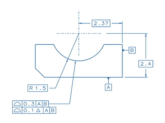

This makes little difference exactly because the basic dimensions can be given in various ways resulting in the same definition, but the following figure is an exact equivalent of the second example from my post in 5 Mar 23 06:50.
I am guilty of paying close attention to what the standard has to say, and I think that the relevant paragraph is "11.10.3 Dynamic Profile Tolerance Applied to the Lower Segment of Multiple Single-Segment Feature Control Frames". The text specifies that "When the dynamic profile tolerance modifier is applied in a segment of multiple single-segment feature control frames and includes datum feature references, the tolerance zone is constrained in translation and rotation, but not size, as applicable.".
If the dynamic tolerance zone has to be constrained in translation, it can not progress/move from the exact location defined by the basic dimensions 2.4, 2.375, and R1.5, which in this case work together to locate the true profile relative to the DRF, while R1.5 also defines the form/curvature. The basic dimensions could also be given as in the original version of the example, and it wouldn't matter. "The tolerance zone is constrained in translation" essentially means that the 0.1 "dynamic" zone is fixed to be centered to the basic arc. Whether this is the fault of how the description in the standard was formed or of the decision to apply this concept to this type of feature is subjective, but this shows the existing problems. And it's part of the reason why I originally said that the modifier only makes sense for features of size. If we wish to apply it to any feature, we can try, but not without consequences.
Burunduk,
I am afraid I am not following you. If this is the interpretation you want to use to argue that the dynamic profile tolerance zone for the non-opposed arc doesn't have any ability to progress away from the true profile, thus the application is invalid, then why don't you see the same problem in case of your first example with the fully closed circle? Is it now because the hole "size" in the first drawing is defined with a basic diameter and not with a basic radius?
pmarc,
In the first example, basic ø3 defines the size of the cylinder, but not its location. The location of the cylinder is defined by 2.4 and 2.375.
In the second example dimensioned as in the second version by 2.4, 2.375 and R1.5, all three basic dimensions combine to define the arc's location relative to the origin of the datum reference frame, including the radius.

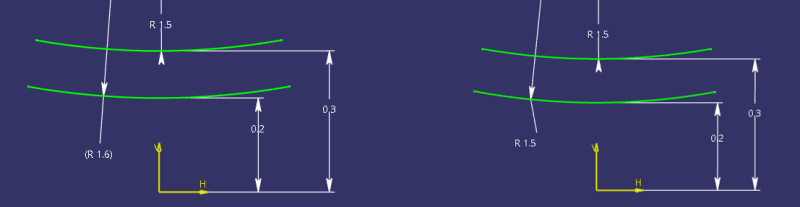

Here is a question - if a radius of 20° arc floats in space relative to its original placement but keeps its value (for example R1.5), do we say it dislocates/translates? I suppose the answer is yes.
If the same radius remains concentric to its original placement but changes the radius value (progresses) do we no longer say it dislocates/translates?
pmarc, let me illustrate the above question.
The 1.5 and 1.6 arcs on the left are concentric. The H and V axes represent the measurement origin. Would you say that the left side image shows two arcs in the same location relative to the origin, while the image on the right represents two arcs at different locations?
If the answer to the above question is yes, does this mean that the only thing that you consider meaningful for the 'translation'/'location' of an arc-shaped/circular feature is the location of its center?
