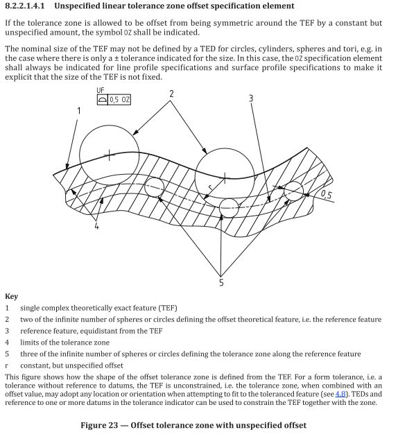

For what it's worth, this is how ISO explains the concept in their 1101:2017. They call it Offset Zone (OZ). No closed contour is needed to explain it. The constraints of the tolerance zone are explained as
a relation of the tolerance zone to the theoretically exact feature (TEF). The presence or absence of datum feature references in the OZ profile callout affects the constraints of the TEF.
They also say this in the very same paragraph:
ISO 1101:2017 said:
NOTE 2: For flat surfaces and straight lines, it is often possible to use, for example, parallelism instead of position to achieve the same effect as OZ.
(Of course remembering that in ISO position can be applied to nominally flat features).

Dynamic profile was originally described in terms of scaling the tolerance zone (in early drafts). Then it was determined that this wasn't quite the mechanism that was needed. One disadvantage was that scaling requires a well-defined point to scale relative to, and the "center" point is only well-defined on simple (i.e. symmetric) closed shapes. Another disadvantage was that when scaled, the tolerance zone doesn't keep a consistent thickness unless the true profile is a simple (i.e. symmetric) shape. It was decided that progression was a better mechanism - it isn't ideal in every way, but it is consistent with other things in Y14.5. Runout zones don't scale - they progress (because the FIM concept is equivalent to the zone progressing). Also, unequally disposed and unilateral profile zones are progressed and not scaled. With progression, dynamic profile is quite easy to add to the existing profile definitions (the constraint-based ones, anyway). If it was scaling, this would be very difficult. We made sure that they defined it in a way that would be clear and straightforward to mathematize ;^).
Thanks to pmarc for posting the ISO 1101 offset zone definition - it's basically (pardon the pun) the same thing as dynamic profile, just defined with different terminology and an additional sphere to represent the offset.
