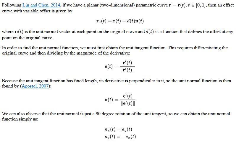

You literally asked for a solid definition, but maybe you didn't phrase the question precisely enough to convey whatever you thought you were asking.
Translation is a special case transformation where each element is transformed by addition of an identical vector. For every point on the original geometry there is a matching point with the same vector offset. It's not "when some geometric element moves from one place to another," which also describes scaling, rotation, and projection.
Everything in engineering is to be carefully considered, particularly understanding the mathematics of general geometry transforms. There are some excellent references online.
It's not different for closed shapes. Just because "progression" can look like translation doesn't mean it is translation.
One can see the mathematical description matches this:
"When the dynamic profile tolerance modifier is applied, the zone is permitted to progress (expand or contract normal to the true profile) while maintaining the specified constant width (distance between the boundaries)."
The effect is this:
No opposition involved or required. It does hint at problems the committee ignores just the same as for profile crossing any sharp corner - that there are portions that are effectively absorbed or extrapolated and it might eliminate small segments entirely or invert connections.

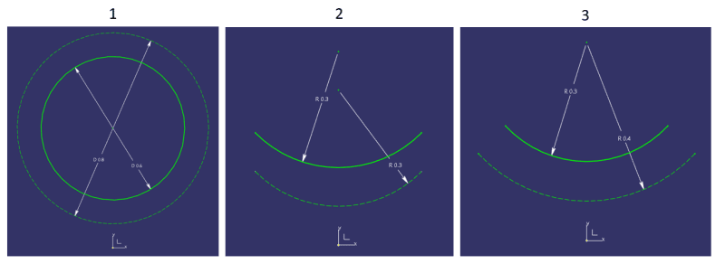

Evan, pmarc, and all
Here is a clarification of where the problem is.
As you may remember, I was addressing the multiple single segment case with the dynamic modifier, which in my opinion cannot be applied the same way for opposed and non-opposed features.
ASME Y14.5-2018 said:
When the dynamic profile tolerance modifier is applied in a segment of multiple single-segment feature control frames and includes datum feature references, the tolerance zone is constrained in translation and rotation, but not size, as applicable
The continuous lines in the 3 cases represent the default position of a true profile, and the coordinate system represents the datum reference frame origin. The dashed lines represent the true profiles after a transformation. In case 1, progression occurred, but the true profile as a whole stayed in a static location relative to the datum reference frame, so the condition of being constrained in translation is met.
In contrast, in cases 2 and 3 the true profile has shifted in the negative Y direction relative to the DRF origin; the overall distance from the origin to the true profile decreased. This means that there could not be an active translational constraint in this direction.
Case 2 is a simple translation, while case 3 is progression per the dynamic profile definition. Contrary to case 1, case 3 cannot take place with a datum reference that constrains Y. This, in my opinion, makes dynamic profile per sub-paragraph 11.10.3 inapplicable to a non-opposed feature.
