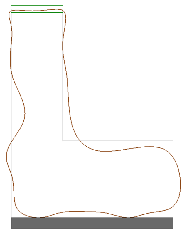

Hello,
This probably has been discussed before, but what's the difference between the two callouts below?
!EDIT! : profile applies between A <-> B. Forgot to add that under fcf.
MSS without datums
MSS with dynamic, w/o datums.
Garland23 said:
They just meant that each segment is verified without maintaining the requirements or constraints of the other segment.
Yes, and this is why I first asked if they're different, because if I were to measure that L shaped part in my example, I'd put it on a CMM table, measure the flatness of the top surface (the 1 mm profile tol.) then I'd measure the height. Software can detect if the surface is out of boundary, then it can validate the height. Or in the case of no modifier, the 6 mm wide zone is overly generous and unnecessary? Because the lower segment "overwrites" the upper?

I agree with Garland23. The statement in 10.5.2 needs to be updated - good catch.
Regarding the drawing with two single-segment profile tolerances, there is an issue with the specification. The lower segment does essentially the same thing as the upper segment, only with a smaller tolerance. The second callout is not just a form refinement - it references A|B| and thus controls the orientation and location relative to both A and B. The toleranced feature is perpendicular to datum feature C, so referencing C doesn't provide any additional control.
If this was a composite profile feature control frame instead of two single segments, then the lower segment would be a refinement of form and orientation, and not control the distance from datum A.

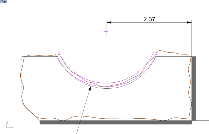

One detail is that the true profile does not progress - it's the tolerance zone that progresses. So there is no issue with overriding the basic geometry from the drawing or model, because that just defines the true profile. The dynamic profile tolerance zone "starts off" as centered on the true profile, and then is allowed to progress away from it. Here is how it would apply on your part with the arc surface:
The dyhamic profile zone (green) has progressed away from the basic surface (black). I literally used the CAD function called Offset to create the boundaries - the Move function would have translated them ;^). Even though we could describe the final result as a combination of translation and shape change, that's not what the transformation was. The zone is still constrained in translation, because we haven't allowed it to translate.
That's true. I was kind of stuck with the idea that a bilateral equally disposed tolerance zone is always centered to a true profile, and so I imagined that if the tolerance zone expands or contracts it accompanies the same behavior of the true profile. It saved me the effort of making a few more circles and arcs in the sketches, but I ended up with an example that doesn't describe the problem accurately enough. Still, it doesn't change the substance of the point being discussed because the requirement of constrained location applies to the tolerance zone, and so if each curve is thought of two parallel curves, the example is still good at showing what I think to be the principally different results of applying the dynamic profile to the 2 types of features. The parallel arcs zone has shifted in location, while the coaxial cylinders zone did not. If the arcs didn't shift in location, does it mean that any element of circular shape, regardless of what portion of a 360° circle it constitutes, can only be located by the center of its radius?
Would the same be true if the toleranced feature was a planar feature instead of an arc, and the dynamic tolerance zone was progressing?
Evan said:
The lower callout controls a combination of size, form, orientation, and location.
I only see how it controls form, orientation and location like you initially said. It doesn't really control size because it can only limit the maximum value up to a maximum of 92.42+1/2=92.92 per the basic dimension from datum B and the profile tolerance value. But it doesn't control the minimum limit of size because the minimum surface-to-surface distance between the toleranced feature and datum feature B would depend on the form and orientation (relative to datum A) controls applied to datum feature B (not shown). So it is outside the scope of that 1 mm profile tolerance with ref. to datum features A and B. Controlling just one limit is not a size control. Do or do not. There is no try.
Any point along the circle has a place the normal vector points at - the new point is in a different location. That there is some average behavior is immaterial.

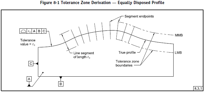

For each point on the true surface create a vector normal to that surface at that point that controls the progression and another along that vector that represents the width of the zone at the tip of those vector normals, then let all the surface normal vectors change magnitude (not direction) simultaneously. If the as-manufactured surface at the intersects all the width normals at some magnitude of the vector normals, then the surface of the as-manufactured surface is conformant to that requirement.
3DDave,
Thanks for the background material on translation. We didn't provide a definition for the term "translation" in Y14.5.1, but the way that it is used is nothing out of the ordinary as far as I know. It's one of the fundamental affine transformations.
Your vector-based definition for the dynamic profile requirement is interesting, very 14.5.1-ish. The profile zone was defined as the locus of line segments that are normal to the true profile:

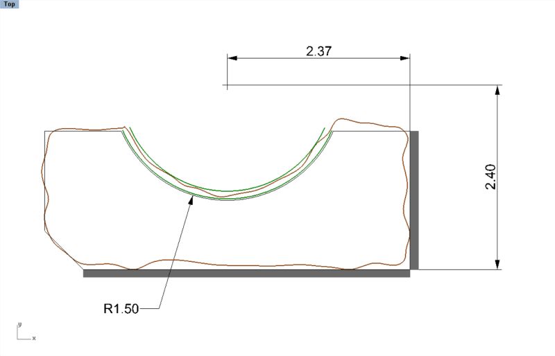

We may have to eventually agree to disagree on this. If we take a short segment of the arc-shaped zone and perform a geometric operation on it, I don't think that the the presence or absence of an opposed portion of zone would change the operation that was performed. I'm not sure that my next comments are going to be any more convincing - especially when we get to the planar surface case ;^).
I'll try to address the questions asked in your last post:
I don't think it means that any element of a circular shape, regardless of what portion of a 360° circle it constitutes, can only be located by the center of its radius. An element of a circle is a special case in that it even has a unique well-defined center. We need to be able to locate shapes that do not have a center (like the irregular feature in Figure 8-19). There is no well-defined center geometry of that shape. You could calculate a centroid, but I don't know if that point would stay constant as the surface progressed. The feature is located (that is, its location is controlled) in the PLTZF due to the fact that we don't allow the zone to translate away from the true profile. It doesn't need to involve a center.
This is what it would look like if we allowed the zone to translate. I've left in the center point to show how far it moved, but we don't really need that.
This zone is what we would result from a composite profile FRTZF (lower segment) that referenced A. The zone is allowed to translate relative to the true profile, but is not allowed to rotate or progress. This is how we defined the action of the FRTZF in Y14.5.1-2019.
If we applied dynamic profile to a planar surface, I would still say that the zone is constrained in location because we haven't allowed it to translate. I know that this will be even more difficult to accept ;^). But I would also say that the end result of progression in this special case is identical to the end result of translation. So applying dynamic profile to a planar surface can get the same final result as applying a composite profile FRTZF. I'll add this to the diagrams if I have time.
There is even some other evidence in Y14.5 to back this up. In the DRF section there are examples of planar TGC's that are described as progressing but not translating. See Figure 7-32 and 7-34.
