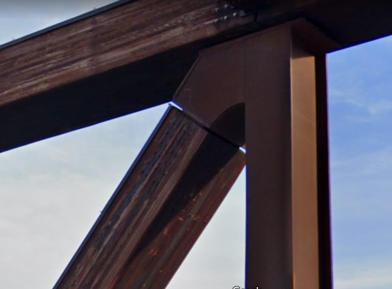

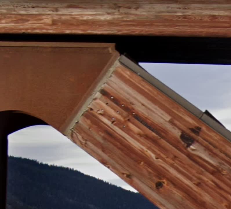

Anybody have a closeup of these 'pins'? Some views look very much like bolts, at least on one end. A nut, a washer, and a projection. But maybe that is all a part of one connector.
I thought I saw a photo where the nuts looked like cap nuts. Obviously not intended to torque into the wood fiber.
The photo which I was referencing was in Little Inch's post of 18 August 11:23. Focus is not too good.
I figure they are (mostly) pins because:
I see no noticeable heads or nuts in those locations--just an array of small holes.

Those do indeed look like bolts. But there appear to be many more of the pinned connections.
spsalso
In the Perkolo bridge photos, there are some heads, some holes on one side. Maybe the dowels were driven from alternating sides.

It looks to me like the bridge was actually built in lots of three or four bays pre fabricated off side and hence they use the pins / dowels on those connections and then bolted into position with the finned multiplate connections. So the connections at those nodes I guess are a bit different to the others. you can spot the connections easily on street view.
More by luck than otherwise it seems one of those connections is right where the stone pillar is.
Also I'm not sure which node this is but its towards the western end and I'm sure it wasn't supposed to look like this...
Also it's opposite neighbour.
And some seem to have been "sealed". So don't know which is correct?

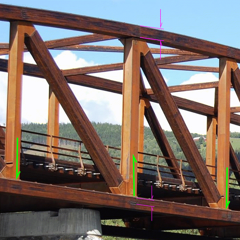

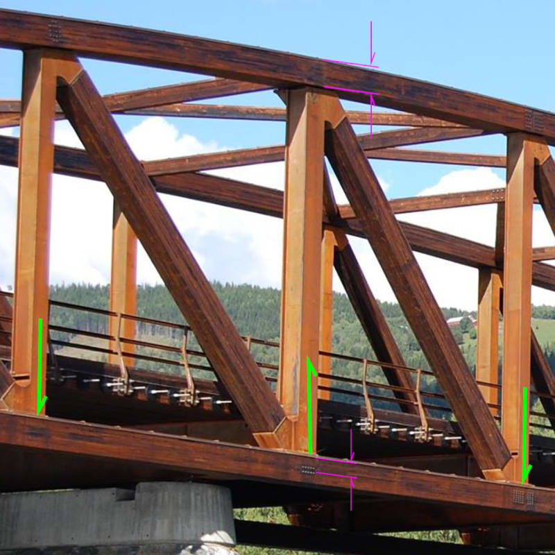

Please allow me one more attempt to convey my thoughts on the problem support.
When the structure flexes, the full depth of the top chord is engaged (vertically) whereas only the top portion of the lower chord is engaged. I see this as a driver for splitting the lower chord and crippling the chord's ability to support the compressive loads it carries.
Splitting of the chord is a possibility, but I don't see it at this node. This node has light forces other than axial compression. That's why there are just a few dowels in the chord. Axial compression is taken by the chord which is continous. Diagonal on the other hand is loaded heavily in tension.
There is no load hanging directly on the chord, as I see it, but rather on steel cross beams which are part of the verticals in the trusses.
Thanks. The truss model shows the diagonal (at node 13 lower) to be in compression when there is a load on the center span. The diagonal at node 14 (upper) is in tension.

Diagonal 5 connects at node 13 (at the support). I wonder if the extended pins are what we see in the image I used above (in the upper and lower chords) which was posted May 2, 2016.

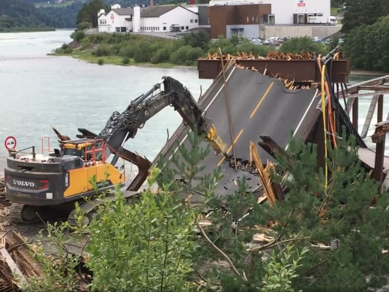

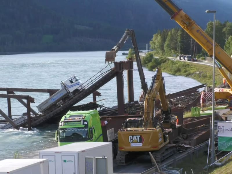

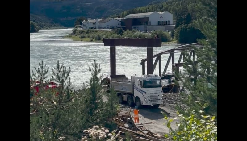

I do hope they are trying to preserve things as much as they can when removing sections of the bridge. That digger driver in the facebook posts doesn't seem to have got the memo....
The truck got dragged out, but was quite a neat way of removing it. It looks empty to me....
