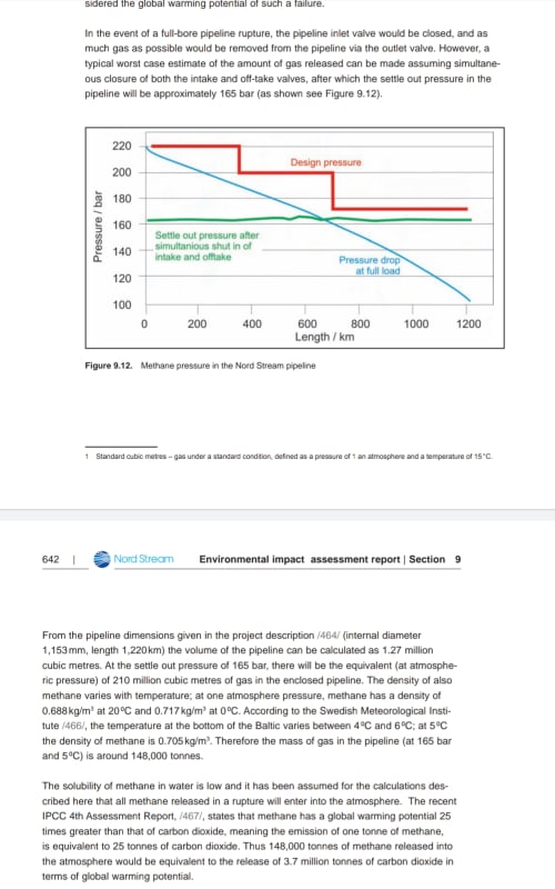

Here's some tech details I was not aware of. This is quite a high pressure design. A 100 barg design pressure for the entire pipeline's length is typical for most pipelines, but NS has 3 segments with different design pressures in each segment ranging from 220 barg at RU inlet that runs for 300 km. It then reduces to 200 barg for the next 375 km, finally dropping to 170 barg for the last 545 km. The pipe is 48" SAWL 485 (70ksi yield). Wall thicknesses of 26.8mm, 30.9mm, 34.6mm and 41mm are reported to have been used. It also is internally coated with a friction reducing epoxy.
Correction to one of my posts above.
Since it has 3 segments with different op pressures, pipeline pressure with no flow must result with a final pressure balancing out at less than the lowest segment's design pressure.

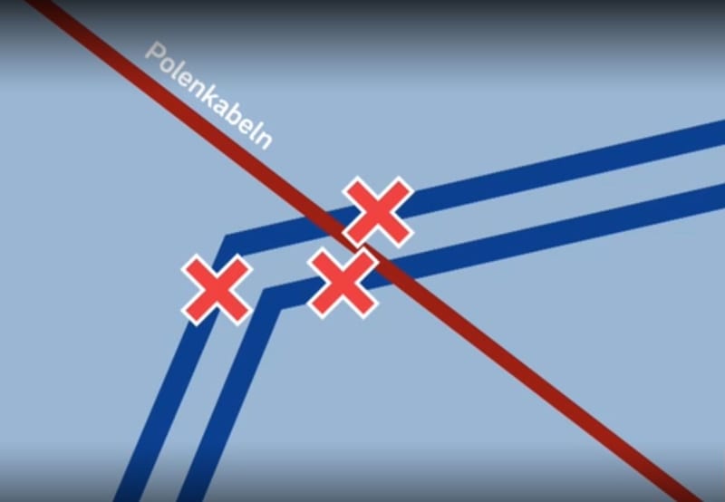

Well I wouldn't bet on Poland mainly because Sweden and Poland have a cable there too, it was shut down for maintenance during the explosions, they are going to measure it and check it next week.
My bet is still on Russia.

If a western country wanted to frame Russia, they wouldn't choose the precise location where the Sweden-Poland power cable crosses.
